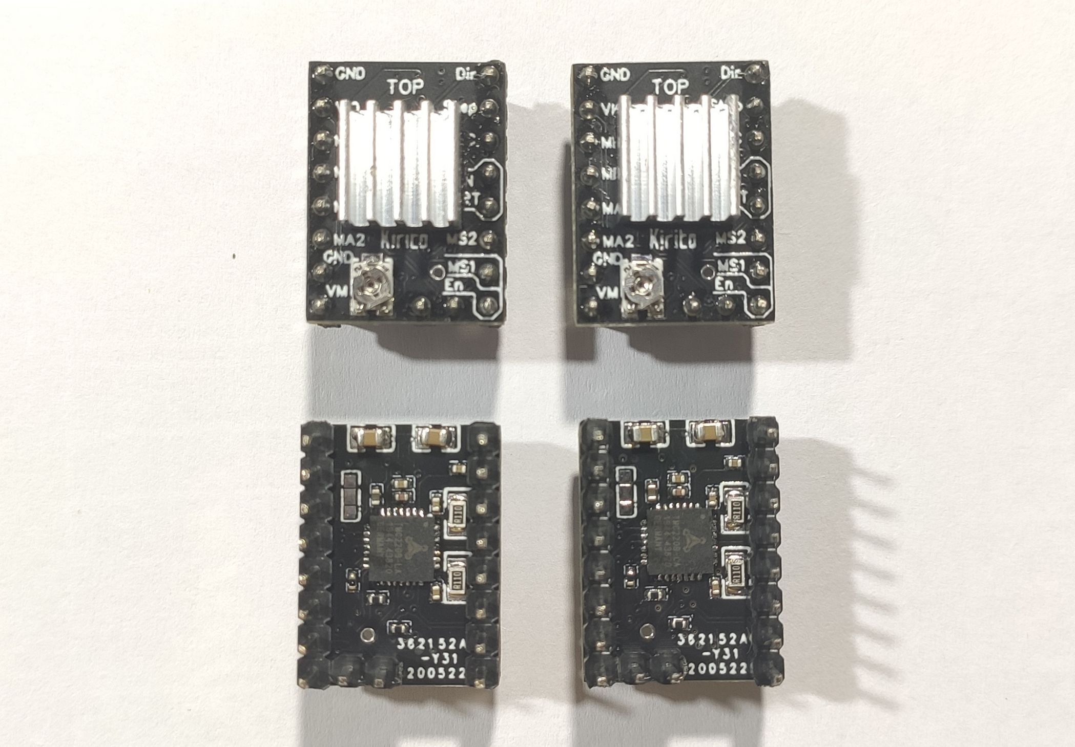

According to the schematic diagram drawn in the data sheet, in view of the price reduction of JLC four-layer boards, I drew a four-layer board (first attempt hhh).
The picture of the actual welded product is as follows. Pay attention to adding a heat sink and adjusting the adjustable resistor to adjust the output current. It is recommended to adjust it to 350mA for 3D printer applications.
Watch the video using the effect. By the way, the stepper motor driven by this driver has almost no sound, almost no sound! My surface fan is louder than his! It is strongly recommended to use TMC2209, whoever uses it knows
