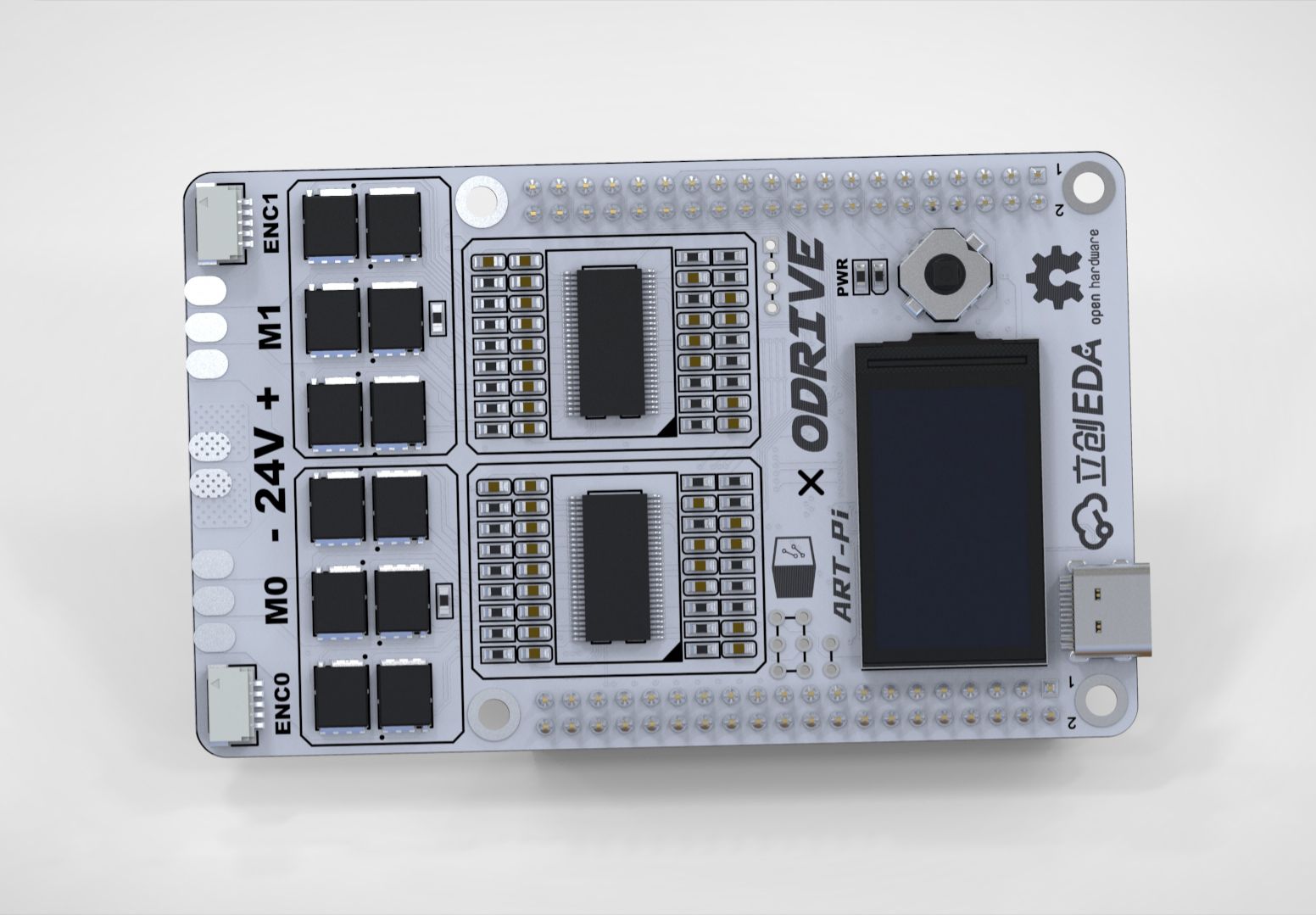

This project is based on ODrive's V3.6 hardware, which is an ART-Pi expansion board (also suitable for Raspberry Pi - only the P1 expansion pin is welded). It can realize two-way brushless motor closed-loop control and has the function of being used for human-machine applications. Interactive screen and five-way switch

project instruction
This project is for the purpose of learning. The ODriver hardware is reconstructed to fit the ART-Pi. The intended driving object is a low-power brushless motor.
ART-Pi is configured through the serial port and uses the serial port or direction/pulse signal or PWM signal to control the expansion board
Compared with the original project, the power dissipation resistor circuit is deleted but the expansion interface is reserved.
Added 1.14' IPS screen and five-way switch, you can choose whether to use ODrive or ART-Pi
Initially, I planned to transplant ODrive to ART-Pi and drive it directly, but due to the limited IO function, I decided to settle for the second best.
Wiring hastily, continue to optimize
(The current version can directly flash the official firmware to achieve basic functions. Boards made before April 7 have bugs and need to modify the firmware)

Modify records
1. (January 19, 2021 02:07) The BUCK circuit of Motor0's DRV8301 is redundant. It is modified to output 12V to power the power dissipation resistor circuit (VGS).
2. (23:46 on January 20, 2021) The wiring and silk screen are sorted out, and the AVCC is used to power the temperature sampling circuit of the brake resistor circuit. The first version of the PCB is finalized. The board name is tentatively ODrive AP. The current version number is 0.1 , full name ODrive AP trial model one
3. (January 25, 2021 16:53) Replace the 47uF/35V tantalum capacitor with the 1812 package 47uF/35V MLCC
4. (February 4, 2021, 17:28) Adjusted the wiring of the sampling resistor part
5. (22:12 on February 6, 2021) Added hardware reset button
6. (20:49 on February 14, 2021) Try to elicit the remaining IO; add a W25Q32 with the intention of saving the settings in W25Q32
7. (March 1, 2021 15:13) The packaging error of the five-way switch has been confirmed and has been corrected. If the board has been printed, the large positioning post at the bottom of the five-way switch can be cut off and then rotated 180° for welding.
// 8. (02:45 on March 5, 2021) Connect the CS/SDA/SCL of the screen to the SPI5 position of STM32F4xxVGT6 (405 does not have SPI5 and is planned to be replaced with 412) (After careful inspection, it was found that 412 and The 405 pins are actually incompatible. If modified, the scope involved would be too large. Careful consideration is needed as to whether to replace it.)
8. (March 18, 2021 19:58) Lead the MCU reset pin to the ART-Pi interface to meet the needs of the ART-Pi forced reset driver
9. (01:57 on March 19, 2021) The interface was split, and the original 14P socket was split into 2 PWM or STEP/DIR or analog signal input interfaces and 2 SPI interfaces (can be connected SPI encoder), a UART interface, the CAN interface is led out in the form of an XH2.54 socket instead of the original pin header; the wiring has been significantly modified, it is only connected at present and needs further optimization; some silk screens have been adjusted (not yet completed ). (The work is still in progress. If you find that the project is being edited, please do not clone it for the time being. It will usually switch back to the release version)
10. (20:02 on March 19, 2021) The second version of PCB is finalized, and the current version number is 0.2
11. (22:05 on March 20, 2021) Added test points for nFault and EN_GATE
12. (April 5, 2021 00:50) Fixed a BUG: SP2 of axis1's DRV8301 accidentally connected to the underlying PGND copper sheet
13. (April 7, 2021 00:07) Fixed a BUG: M1_SO1/M1_SO2 connection sequence is wrong
14. (20:15 on April 8, 2021) The order of the IN0/IN1 interface has been adjusted (the PCB only changes the silk screen) to comply with usage habits
15. (April 13, 2021 at 20:44) The pin sequence of the IN0/IN1/CAN interface has been adjusted to make it more consistent with usage habits; the power supply of the IN0/IN1 interface has been modified to 5V. This pin should usually not be used. However, if a single power supply is used, the control board can be powered from this port.
16. (April 29, 2021, 18:29) The current sampling method is changed from single-ended sampling to differential sampling; 3.3V/A3.3V/5.0V/12.0V test points are added, and silk screens are added to all test points; Added a new NRST reset pin, connected to the PA15 pin of ART-Pi, and retained the old reset pin connection to be compatible with the old version of the program; replaced 1117 with RT9193-33; changed the design idea to focus on practicality, and added some interface descriptions Description silk screen; upgrade version number to 0.3
17. (May 4, 2021 18:55) Fixed a bug. The effective level of the EN pin of RT9193-33 is wrong. It should be high level enable.
18. (19:12 on May 31, 2021) DRV8303+TPS54160 replaces DRV8301. The program is fully compatible and no changes are needed. Create a new project to separate the 8301 version and the 8303 version.
https://oshwhub.com/Knight_Sin/abcd_copy_copy_copy_copy_copy
19. (00:34 on June 17, 2021) Removed some IO leads, modified the wiring, and continue to streamline and optimize
