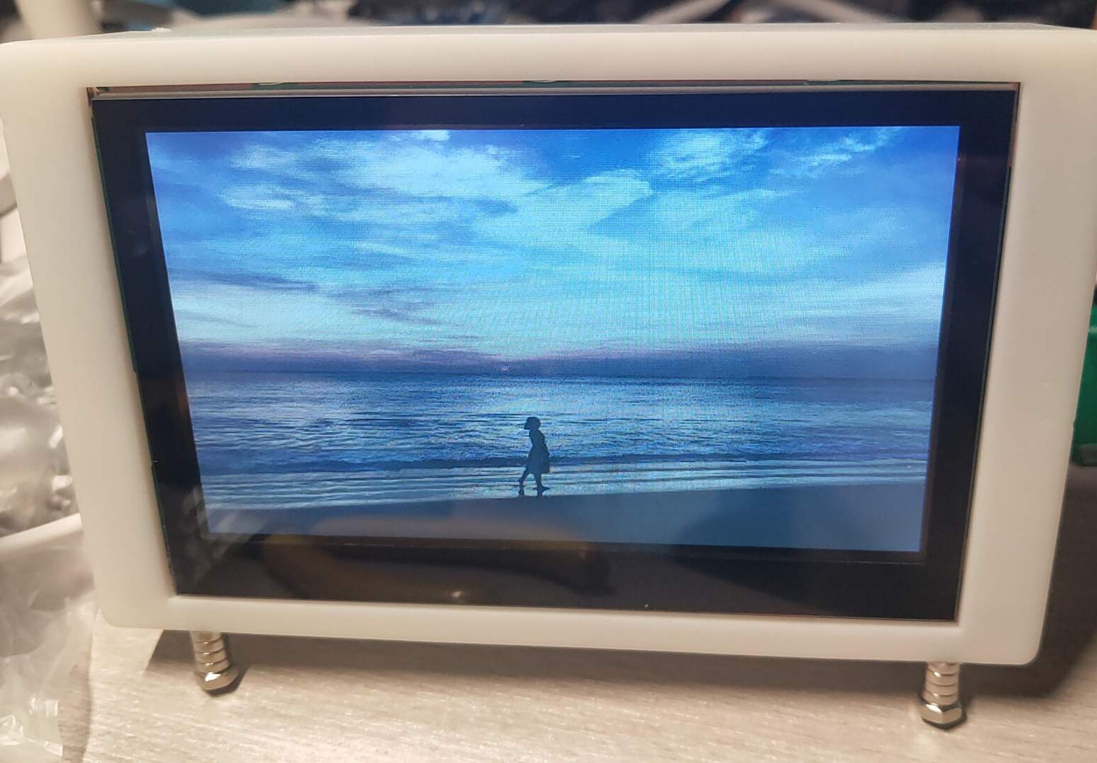

Onboard functions
Tuya WB3S module
Communicate with the Tuya IOT platform through the WB3S module to obtain information such as weather and time (automatic time adjustment for RTC); control home devices (based on device linkage); report temperature and humidity; and OTA upgrades.
JDY-31 Bluetooth module
Establish a Bluetooth connection with the computer through the Bluetooth module, transparently transmit the computer data through the Bluetooth serial port, and display it on the screen.
SHT30
Obtain the ambient temperature and humidity and report it to the cloud and display it on the screen.
TEMP6000
Get the ambient brightness and perform automatic brightness adjustment of the screen.
screen development
The screen uses Divin Technology 03W and is developed using DGUS. Part of the development of the relevant interface has been completed. The main interface is as shown in the figure Image 3.png
