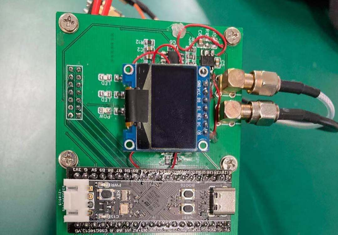

This differential amplifier circuit tester uses STM32F411 as the microprocessor. By inputting different signals to the differential amplifier circuit and measuring the amplified signals, it completes the measurement of the amplification factor, input resistance, and amplitude-frequency characteristics of the amplifier circuit. At the same time, the tester can also be used as a sinusoidal differential signal generator, which can generate a sinusoidal differential signal with adjustable frequency and amplitude. The common mode signal is obtained after PWM low-pass filtering, and the differential mode signal is generated by AD9833 . At the same time, input the common mode signal and the differential mode signal into the addition and subtraction circuit to output the differential signal. After the differential signal generated by the differential signal source passes through the differential amplification circuit, it first passes through the subtraction circuit to filter the common mode signal, and the resulting differential signal is high-pass filtered, maintained by the peak detection circuit, and then detected by the ADC . STM32F411 is responsible for controlling the measurement process, analyzing and processing the measured data, calculating the input and output resistance and frequency characteristics of the differential amplifier circuit, and drawing the corresponding characteristic curve through OLED to complete the characteristic test of the differential amplifier circuit. This system has the characteristics of low power consumption, low cost, convenient control, friendly human-computer interaction, and stable working performance. It can be regarded as a superior solution for differential amplification circuit tester.

3.1 System composition
This system consists of 5 parts, as shown in Figure 3-1 , which are data processing system, data input system, display system, differential signal source system, and differential signal detection system.
The data processing system mainly consists of STM32F411 , which is responsible for data processing. The data input system mainly consists of a matrix keyboard, which is responsible for completing the operation of users entering data into the system. The display system is mainly composed of an OLED display screen, which is responsible for displaying the results on the screen. The differential signal source system is responsible for receiving the requirements given by the data processing system and generating corresponding differential signals. The differential signal detection system is responsible for detecting the differential signal output and passing the data to the data processing system.

Use wires to connect the tester and the circuit under test, and conduct the test multiple times. Statistics of the total time taken for a complete measurement are recorded. The measurement results obtained from each measurement are recorded and the variance is calculated. The average system time measured was 23.4s.
It can be seen from the measurement results that the system runs quickly, and the variance of each parameter is small under different measurements. This shows that the system operates stably and the measurement result deviation is small.
