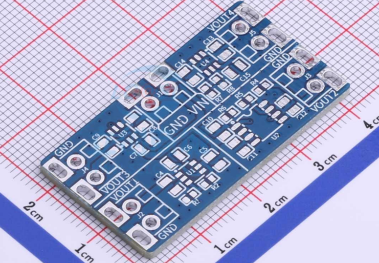

The board integrates 4 circuits, shares the input power supply, and is compatible with a variety of switched capacitor (charge pump) DC-DC converters.
V1.0: U1 is missing one ground wire and is not connected. Use a jumper to connect it first when testing. This problem will be fixed in the next version.
