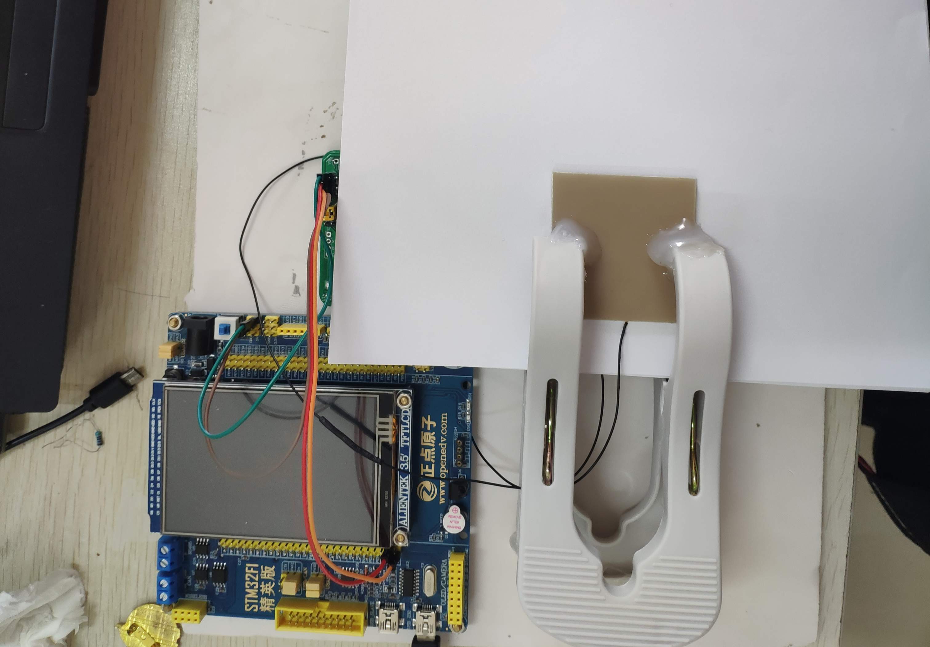

Therefore, in this money-saving version, we used large clips that many students wanted to use, but were afraid to use.
Sorry, I misplaced it. This is a small clip.
Thumb~thump~thump~thump~
src=http___www.t-jiaju.com_tujjJDAxJDIyLzEwOTM1MTc2NjcvVEIyTm12U1g2ZnlRZUJqeTBGcFhYY1hDRlhhXyEhMTA5MzUxNzY2NyQ5.jpg&refer=http___www.t-jiaju.jpg
It's this big clip.
Convenient, simple and practical.
Because it was considered that it would tilt due to gravity, we used the most commonly used glue gun to fix it on a huge board, using gravity to keep the clip itself from changing.

But because it doesn’t cost money , the structure is simple and we can’t pass it.
The pole pieces are compacted with heavy objects to squeeze out the air between the papers in the pole pieces as much as possible to reduce the impact.
Therefore, we thought about it. Because the thickness of the paper changes, the pole pieces are forced to tilt up. As long as we set certain ranges for separate measurements, will the data I get be the most real and effective?
So, another series of violent solutions... (worksheet:?, MATLAB:?, spss:?)
After careful study, we found a small loophole in the performance requirements of the question. We added a judgment in the program. As long as my measurement value is within a certain range, we will switch to the "warp up" mentioned above. "Looks like" corresponding to the frequency.

Because this design uses a clip that most people only dare to think about, during the design process, the choice of this clip took a long time. When testing within 30 pictures, this clip basically "clamped" The size of the "force" will not have much impact, because we are using completely new paper taken out of the packaging, and the impact of this aspect has been ignored as much as possible.
Finally, there is this area, which is also one of the highlights of this design. We made full use of the phenomenon that the clip will "cock up" when clamping too many things. We tried repeatedly and selected different frequencies. Frequency tables that are best suited for different papers.

At present, the measurement accuracy has been able to fully realize the detection of 63 pictures.
Because the storage capacity of AT24C02 is 256, a float occupies 4 bytes, 63x4=252.
According to theory, in principle, the storage can continue to be expanded, and the measured value can be the maximum number of papers that the clip can hold, and the estimated estimate is 80+.
