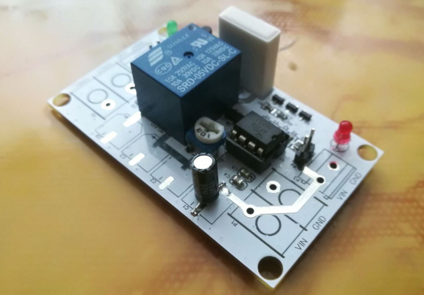

[Successful test] Anti-overload protection circuit
The circuit is copied from Zhou Guangx's "Shield for Electronic Beginners!" Teach you how to make an overload power-off protection circuit》
B station video
CSDN link
Instructions:
  1. Power on, turn the potentiometer counterclockwise to the maximum value, press the button, and the relay will close.
  2. Slowly turn the potentiometer clockwise until the relay just opens
  3. Rotate the potentiometer counterclockwise a little, press the button, the relay will close, and you can start using it.
  4. When a circuit is overloaded. Short circuit, the relay automatically disconnects
  5. After removing the fault, press the button to continue using
