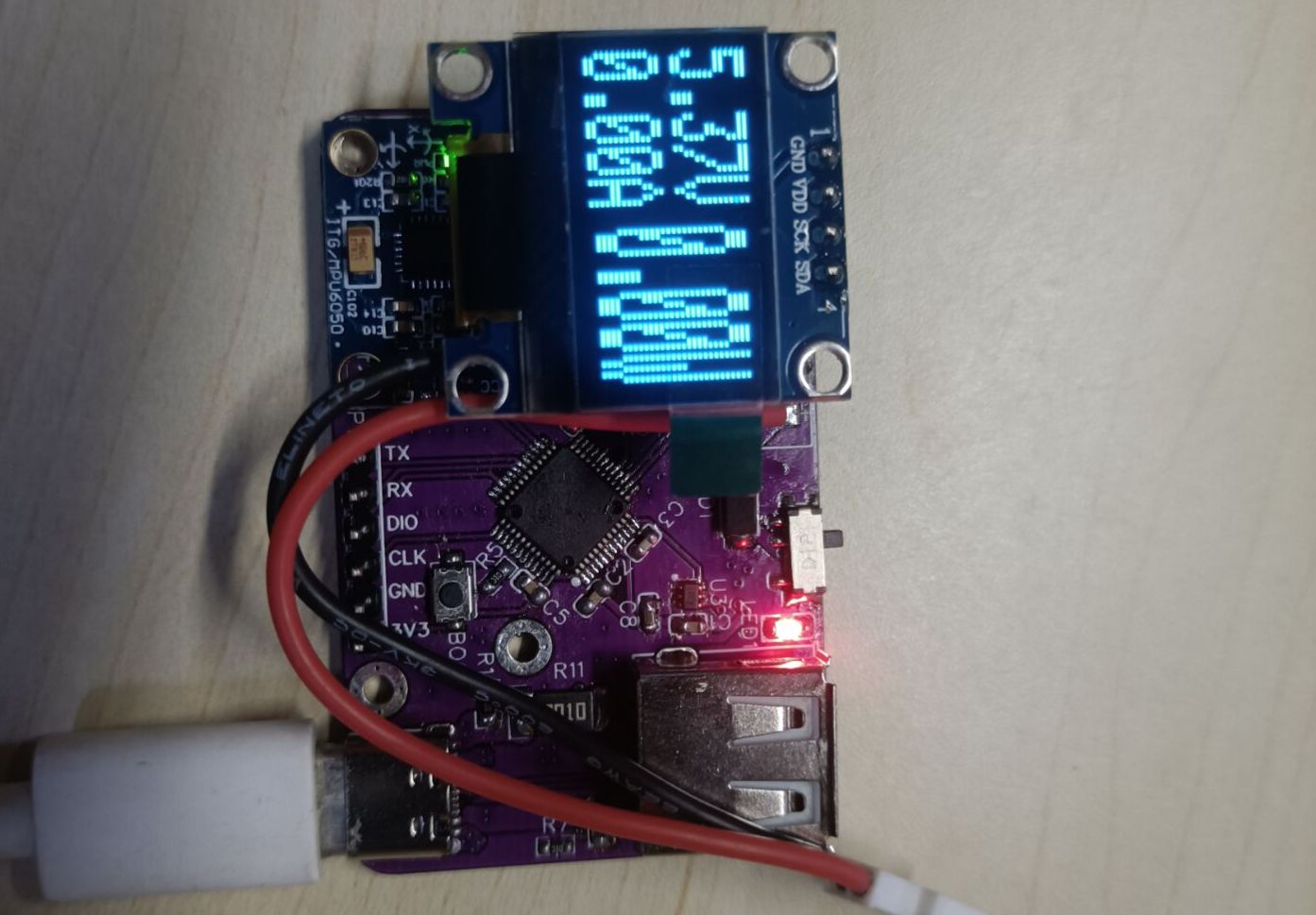

The National Technology MCU is used as the main control, integrating voltage and current measurement and real-time attitude sampling, using INA199B1DCKR for current sampling, and mpu6050 for attitude measurement. In theory, it can pass 5V, with a maximum current of about 2A. The battery interface is reserved, which can be used as a portable attitude meter. The purpose of the design is to use the same set of programs for the two functions and integrate them on a board. Due to the limited personal software ability, the program has not been integrated at present, but two sets of programs can be used, and the verification has passed.
