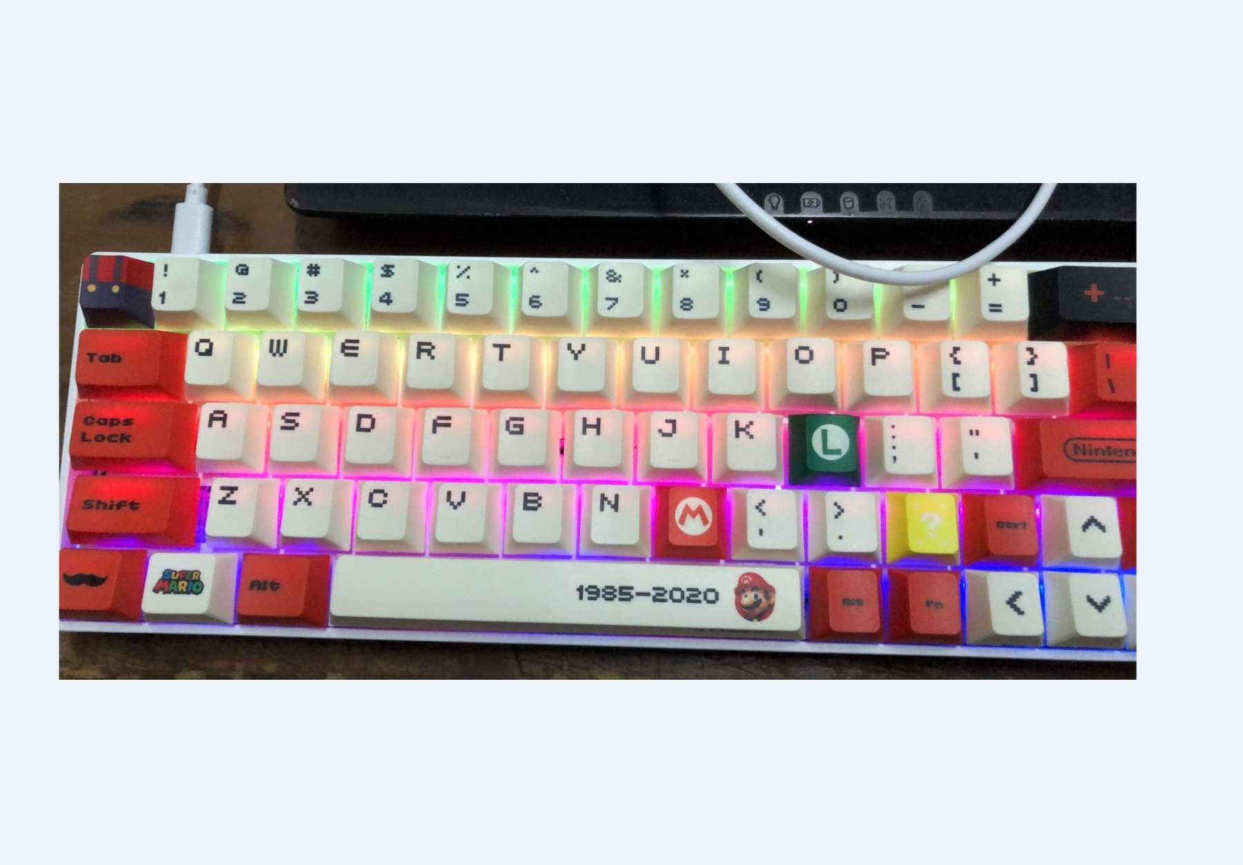

QMK firmware is completely open source. Students who can compile can install the QMK environment by themselves to compile the firmware with the functions they like.
Students who don’t know how to do it can use the firmware I uploaded. In addition, the json file in the attachment is the key position and main control pin. You can compile the firmware yourself and upload it.
hex is compiled firmware and can be used directly. When purchasing the master controller, try to purchase it at Lichuang Mall. Many of them are refurbished on Taobao and cannot be used to directly flash the firmware via USB. A burner is required to burn BL first.
In terms of shell, it is compatible with most 60% shells on the market.
