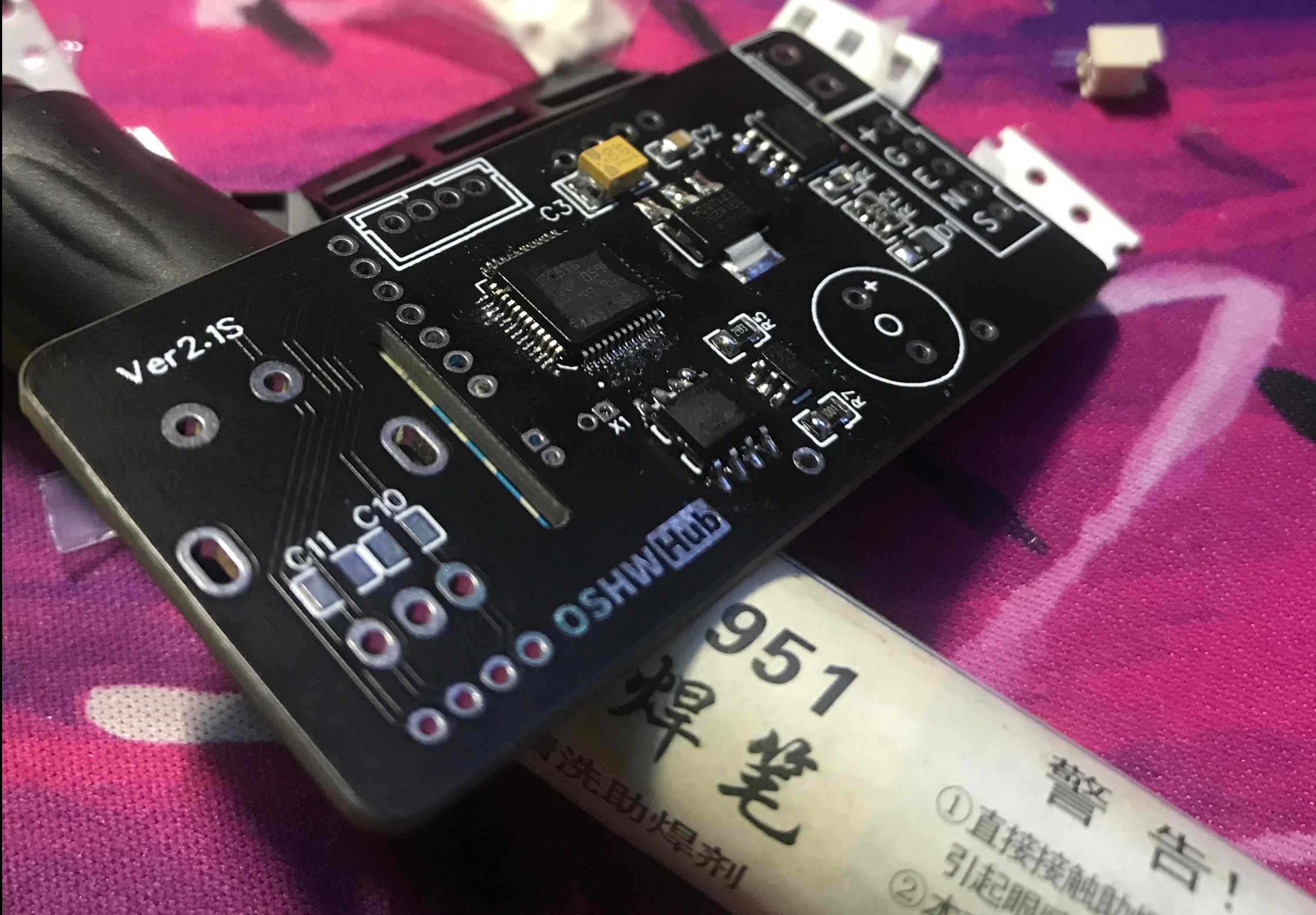

First of all, this soldering station control board is not my own creation. The data is collected from the Internet and optimized. The original author @CNC
Production experience:
  • It is recommended to buy LDO chips from Lichuang. Taobao is all fake. My phone crashed many times during the production process. They were all SPX2954M3 bought from Taobao.
  • The operational amplifier IC is marked as SGM8551 in the schematic diagram. In fact, it can be replaced by RS8551, GS8551, MCP6001, OPA336 and other operational amplifier models.
  • In the schematic diagram, try to use 0.1% of the 249K resistor.
Screen support:
  • Support OLED 0.96 1.3 2.42 and other sizes
  • The driver supports OLED screens of SSD1306 SH1106 CH1116 SSD1315 SSD1309 and other driver models. When burning firmware, select the firmware according to the selected screen size.
I'm not very good at taking photos, please forgive me.
QQ picture 20200916000617.jpgQQ picture 20200916000626.jpgQQ picture 20200916000631.jpgQQ picture 20200916000634.jpgQQ picture 20200916000639.jpgQQ picture 20200916000641.jpgQQ picture 20200916000646.jpgQQ picture 20200916000651.jpg
Function description: Using STM32 main control, with time display, voltage display, low voltage protection, welding tip management, temperature segmented calibration, screen saver, temperature enhancement, automatic standby, automatic sleep, NTC temperature compensation, password protection, Chinese and English switching , buzz reminder and other functions.
