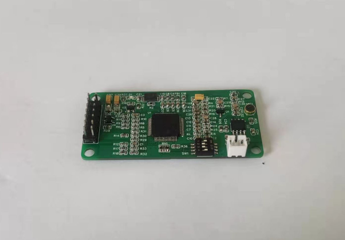

1. The base plate design adopts a modular design with a compact layout to save resources and costs.
2. Pure offline module.
3. Adopting a double-layer board design, from left to right are: interface, power supply, voice module, and power amplifier. Voice input microphone and speaker interface.
4. Supports the synthesis of any Chinese text and English text, and supports mixed reading of Chinese and English. The chip supports the synthesis of any Chinese and English text, and can use  four encoding methods: GB2312 GBK BIG5  and  UNICODE  . The amount of text synthesized at a time can be up to  4K  bytes.
The chip analyzes the text. For text in common formats such as numbers, numbers, time, date, weights and measures symbols, the chip can correctly identify and process it according to the built-in text matching rules; it can also correctly identify and process general polyphonic words according to their context. Determine the reading; additionally
For texts in both Chinese and English, mixed reading in Chinese and English can be achieved.
5. Supports voice codec function. Users can use the chip to record and play directly. The chip integrates a voice encoding unit and a decoding unit, which can encode and decode voice to achieve recording and playback functions. The chip's voice codec has high compression rate, low distortion rate,
It has the characteristics of low latency and can support a variety of voice coding and decoding rates. These characteristics make it very suitable for digital voice communications, voice storage and other occasions that require digital processing of voice. Such as: vehicle-mounted WeChat, command center, etc.
6. Supports speech recognition function and supports the recognition of 30  command words. The default setting of the chip is  30  commonly used recognition command words in automotive, early warning and other industries.
7. Supports  three communication methods: UART I2C  and  SPI.  The UART  serial port supports  communication baud rates that can be set:  4800 bps 9600 bps 57600 bps 115200 bps. You can choose the baud rate you need through hardware configuration according to the situation. . 8. Supports a variety of control commands, such as text synthesis, stop synthesis, pause synthesis, resume synthesis, status query, enter power saving mode, wake up, etc. The controller sends control commands through the communication interface to control the chip accordingly. The control commands of the chip are very simple and easy to use.
For example: the chip can play prompt sounds and Chinese text through a unified "synthesis command" interface, and can also set synthesis parameters through marked text.
principle
1. The minimum system requirements of the speech synthesis system include: controller module, XFS5152CE  chip, power amplifier module, and speaker. If you need to use the speech recognition function or speech encoding and decoding function, you need to add a microphone to the system.
2. In the speech synthesis system, the main controller and  the
XFS5152CE  chip can be connected through  the UART  interface,  I2C  interface, or  SPI  interface. The controller can send control commands and text to the XFS5152CE  chip through the above communication interface  , and the XFS5152CE  chip receives the text. It is then synthesized into a voice signal for output, and the output signal is amplified by a power amplifier and then connected to a speaker for playback. 3. When using the speech recognition function, the host computer sends a command to activate the speech recognition function to the speech chip. The chip converts the speech data collected from the microphone into the corresponding recognition result through the internal recognition module, and transmits it back through the communication interface. to the controller. 4. When using the voice codec function (the communication interface must select  the UART  interface, and the baud rate is set to 115200bps ), the host computer sends a command to start codec to the voice chip, and the voice codec module inside the chip converts the collected audio The data is encoded and transmitted to the host computer in real time through  the UART  interface, or the audio data transmitted from the host computer is decoded and played in real time.
The minimum system requirements of the speech synthesis system include: controller module, XFS5152CE chip, power amplifier module, and speaker. If you need to use the speech recognition function or speech encoding and decoding function, there is a motherboard, microphone, and speakers. In the speech synthesis system, the main controller and the XFS5152CE chip can be connected through the UART interface, or I2C interface, or SPI interface. The controller can send control commands and text to the XFS5152CE chip through the communication interface. The XFS5152CE chip receives the text and synthesizes it into Voice signal output, the output signal is amplified by the power amplifier and then connected to the speaker for playback. When using the speech recognition function, the host computer sends a command to activate the speech recognition function to the speech chip. The chip converts the speech data collected from the microphone into the corresponding recognition result through the internal recognition module, and sends it back to the controller through the communication interface. . When using the voice codec function (the communication interface must select the UART interface, and the baud rate is set to 115200bps), the host computer sends a command to start codec to the voice chip, and the voice codec module inside the chip processes the collected audio data. Encode and transmit it to the host computer in real time through the UART interface, or decode the audio data sent from the host computer and play it in real time.
5. For recording function, the microphone module can be designed with reference to the following circuit. The MIC bias voltage MIC_BIAS is output by pin 12 of the chip. The network label MIC in the circuit in the figure is the microphone access point.
