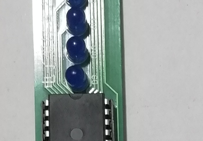

1. The microcontroller used is 51 microcontroller; 2. The font uses modulo software; 3. Using IN4170 diode can reduce the resistance and does not need to be pulled up on the P0 port; 4. The program can be downloaded through the built-in TTL adapter cable, and the data cable during downloading RXD is connected to TXD port, TXD is connected to RXD; 5. Please refer to the attachment for the program; //-- Huan--
0x04,0x10,0x34,0x08,0xC4,0x06,0x04,0x01,
0xC4,0x82,0x3C,0x8C,0x20,0x40,0x10,0x30,
0x0F,0x0C,0xE8,0x03,0x08,0x0C,0x08,0x10,
0x28,0x60,0x18,0xC0,0x00,0x40,0x00,0x00,
For the sake of intuition, let’s sort the above dot matrix according to the PCB wiring method:

1 means on, 0 means LED is off; after removing 0, it is the word "happy"
