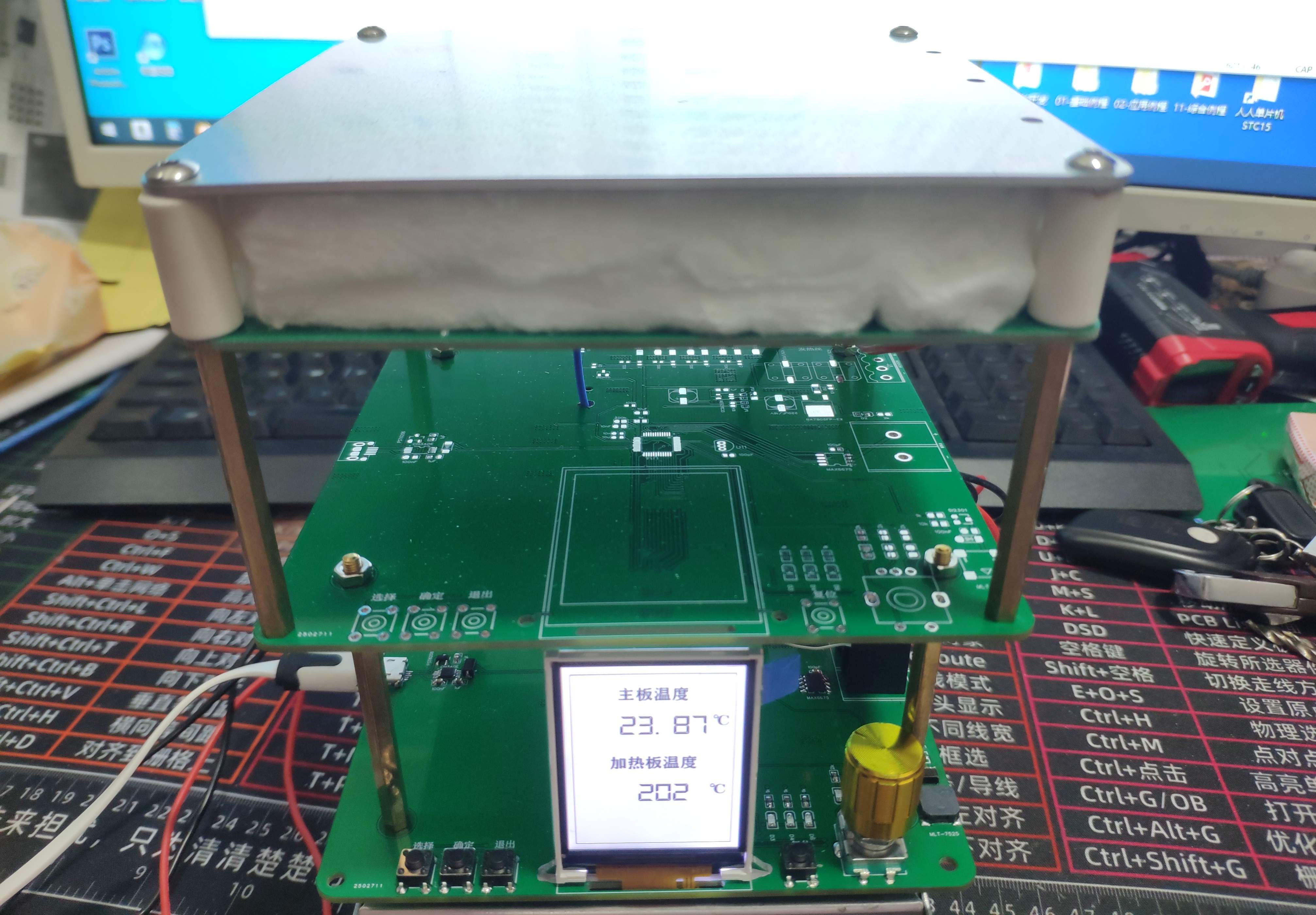

First burn the "Bin File Download Program" and press the select button to clear the flash memory. When the red light turns on, it means clearing is complete. Then the serial port assistant sends "Comprehensive" to 25Q64, and finally burns in the STC8 main program.
A 12V15A power supply is required. DS3231 is not soldered yet. The function is still being improved. . . . . . . . . . .
