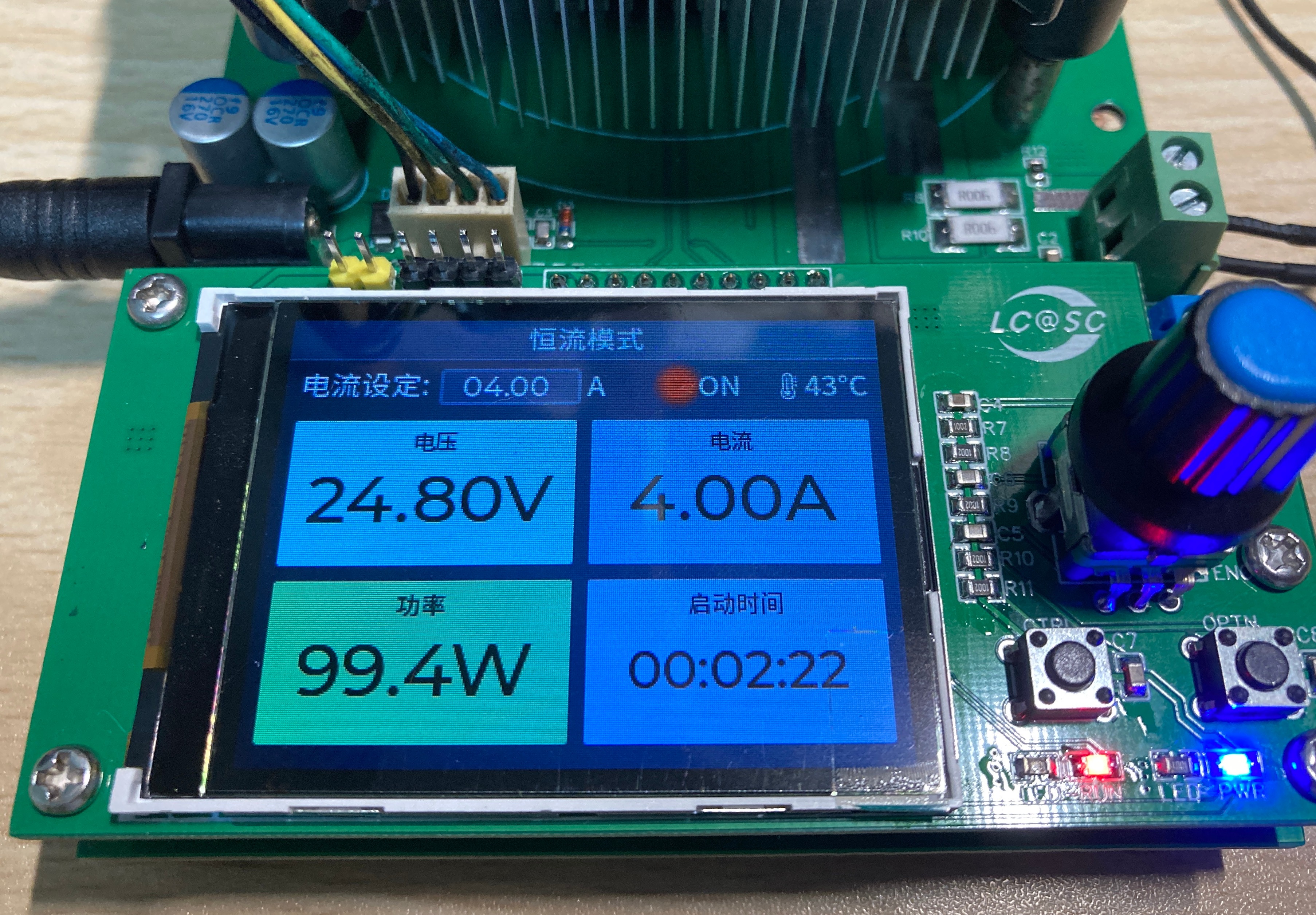

1. Project details
Electronic load is a device that consumes electrical energy. Its main function is to test the power supply. Compared with traditional passive loads such as high-power adjustable resistors or electric furnace wires, electronic loads have many advantages such as adjustable parameters and ease of use. Whether you are a professional electronic engineering project developer or an amateur electronics enthusiast, the electronic load meter is one of the necessary equipment. For example, the directional theme of this competition is "DC Adjustable Power Supply Design". If you have an electronic load, it will be more convenient to debug the power supply and accelerate the development of the project.
Electronic loads can be divided into AC electronic loads and DC electronic loads based on the type of test power supply. In terms of function, there are four common types: constant current, constant voltage, constant resistance, and constant power. Because most of our common power supplies are constant voltage DC power supplies. When testing this type of power supply, the main test is its current output capability. Therefore, in most application scenarios, DC constant current electronic loads are the most common type. In terms of control methods, electronic loads can be divided into two types: numerical control and analog. Compared with electronic loads controlled by pure analog circuits, CNC electronic loads use digital control, which is more intuitive in parameter adjustment, has rich functions, is simple to expand, and can also easily realize test automation.
Based on the above analysis, I decided to make a CNC DC (constant current) electronic load. Since the CNC electronic load can realize the function of a pseudo-constant power electronic load through simulation, the word "constant current" is not explicitly stated in the name, but it is essentially a constant current electronic load.
When the project was established, the key technical parameters I set were:
  1. Maximum test current: 10A
  2. Maximum test input voltage: 36V
  3. Maximum power: 120W
  4. Current control range: 0.1~10A, control accuracy: 0.1A
The above target parameters and functions of the final product have been achieved.

显示部分采用了2.4寸的6.5K色QVGA分辨率的TFT显示屏,比起小尺寸的OLED或者单色STN显示屏,彩色的TFT显示屏可以同屏显示更多内容(或更加明显的显示内容),也可以提供更加优良的观感,并且为以后的功能扩充留下了更多的余地。并且,彩屏TFT并未明显增加成本。
用户控制部分使用了一个带中心按键的旋转编码器和两个按键,旋转编码器用于快速选择选项或者设定数值,两个按键则一个实现控制另一个作为功能键使用。
这里还提供了两个指示灯,一个作为负载运行的指示灯,另一个则作为电源指示灯。

五、项目图片
含有大赛LOGO特写图片
其他图片
正面
侧面
控制板和模拟板分离照
实际运行图1
实际运行图2
性能展示——电压准确度
性能展示——电流准确度
性能展示——最大负载功率和四线电压
