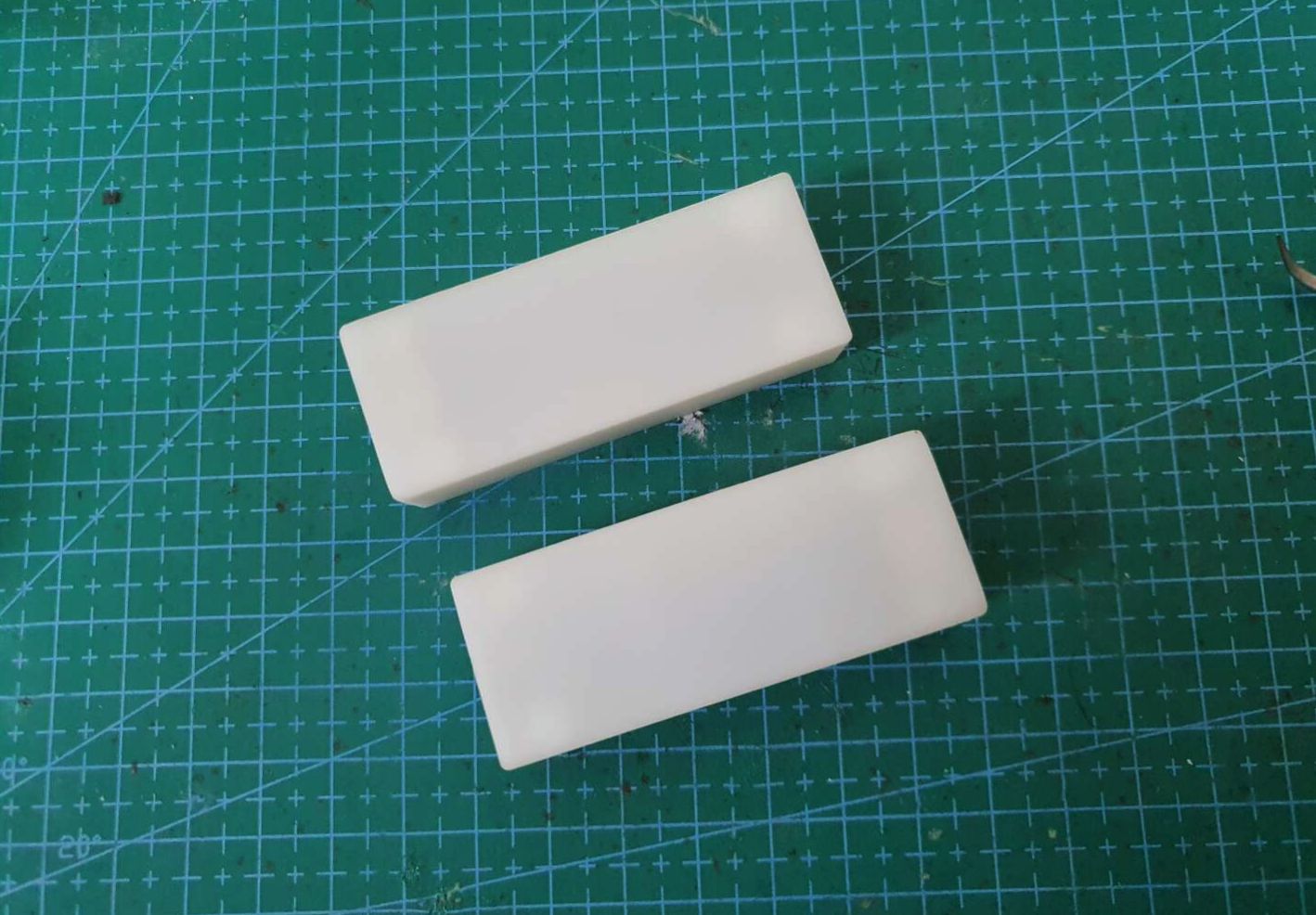

Module description
  • The input supports multiple protocols such as PD QC. The default input is 15V. If there is no 15V level, 12V will be used.
  • When using a 15V 3A power input, the output power can reach a maximum of 40W (it will automatically enter protection after long-term use, and it can be restored by disconnecting the input and reconnecting it). The 20W power test runs stably for 3 hours for a long time.
  • See the attachment for the matching 3D printed shell.
Component Description
  • Decoy chip, FS312, if you need to use 15V, you need to use FS312H, connect a 140K resistor to decoy 15V, connect a 100K resistor to decoy 12V
  • For the buck module mini560, you need to replace a resistor with a 12K resistor. Please purchase a 0603 resistor by yourself. For details, see the video https://www.bilibili.com/video/BV1Bh411z7kT/
  • The 3D printed shell needs to be installed using M3x8 self-tapping screws. If it does not need to be disassembled later, hot melt glue or other glue can be used for installation.
Finished product picture
Finished product
Finished product with shell
