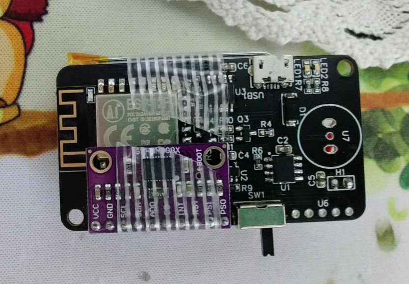

This project is the open source hardware of SlimeVR that I drew personally. Please go to the official github to view the software and firmware part or view the official DIY tutorial.
The main parts are:
ESP12F (ESP8266)
GY-BNO08X sensor module
TP4056 lithium battery charging IC
RT9013-33GB lithium battery voltage stabilizing IC
CH340K serial port IC
ESP8266 automatic download circuit
1200mah lithium battery
Circuit description
The circuit part includes automatic download circuit and manual download circuit respectively. There is no need to weld components numbered C7, R13, R12, RTS, FLASH in the manual download circuit part if there are no special needs.
Number U7 is a magnetic connector, which is reserved for subsequent 5-way magnetic chargers. You can also charge directly with a data cable. If you don’t want to use magnetic connectors, you don’t need to solder the components numbered U7 and D1.
The number BAT is the battery interface
Number U6 is the second sensor interface, which can be connected using a connector with a pitch of 2.54mm.
The serial port needs to be recognized after soldering the battery, so please turn on the switch after soldering the battery and then burn the firmware.
※: Now the price of GY-BNO08X module has increased to ridiculous levels, and the BNO085 sensor IC is also out of stock. When the BNO085 sensor IC is in stock, we will directly integrate the IC into the PCB, which will be much cheaper than using modules.
