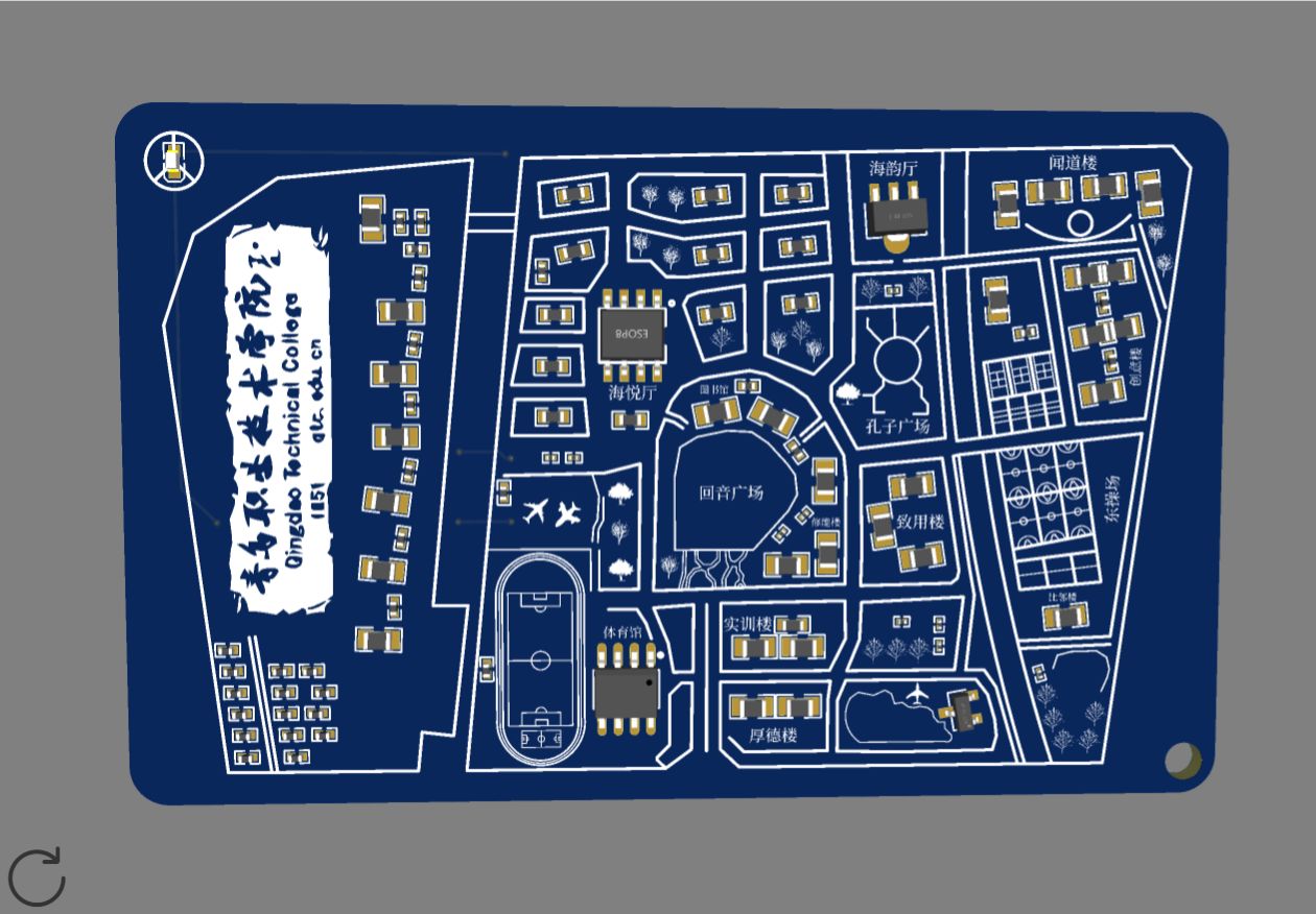

## I have been envious of campus cards for a long time, but I have never had one from my own school, so I borrowed the open source from Mazhiliang and drew an NFC campus card myself.
## After actual verification, cut out the chip in the campus card (use a flashlight to illuminate the small opaque part of the campus card, which is the chip) and solder it on. It also adds a 0603 packaged light-emitting LED function, and the soldered green LED After testing, it can still light up normally without adding a resistor. The place where the resistor is soldered is next to the campus card chip on the back. If you don't add a resistor, please short-circuit it.
## Some of the silk screens inside are too close. The actual patterns on the board may be connected. We will continue to improve them in the future. Thank you everyone!
