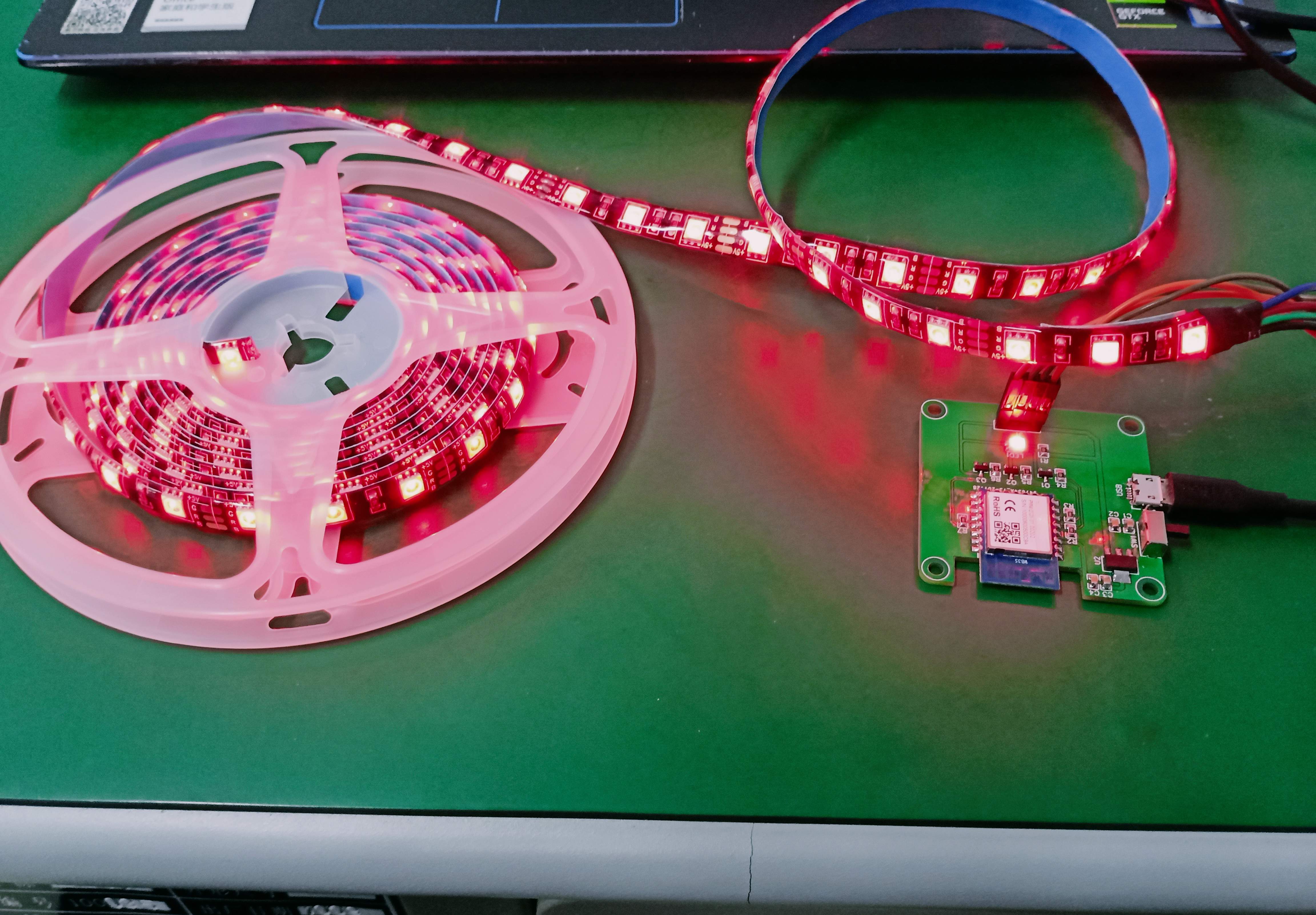

Combined with the current development trend of the Internet of Things and referring to the training camp tutorial content, I produced my project "Internet of Things RGB Light Strip".
Creation characteristics
Test your learning results from participating in this training camp, contribute to the improvement of your skills, and add project options for your own electronic club activities.
creative effect
This project is suitable for use in multiple scenarios such as homes, KTVs, and outdoor lighting.
Design and production process
Due to lack of experience, the circuit design part was carried out by referring to the circuit provided by the training camp instructor. The PCB part was produced by myself recently, so there was no problem with these two.
During the production and debugging process, except when configuring the network of the Tuya smart module, I encountered some problems due to reasons such as not reading the reference materials in advance, and then solved them through my own exploration.
Power circuit part
Through the USB interface, input a +5v DC voltage, and then through the linear regulator, the 5v DC voltage is stepped down to a 3.3v DC voltage.
The +5v DC voltage powers the RGB display in the circuit and the external RGB light strip.
The 3.3v DC voltage powers the entire Tuya smart module.
Linear regulator section
Referring to the reference materials provided by the linear voltage regulator and Mo Gong’s many years of experience, you need to add a 10uF chip capacitor, a 22uF chip capacitor and two 100nF chip capacitors around the linear voltage regulator to make this linear voltage regulator Achieve the best working results.
​Please watch the video for function demonstration.
