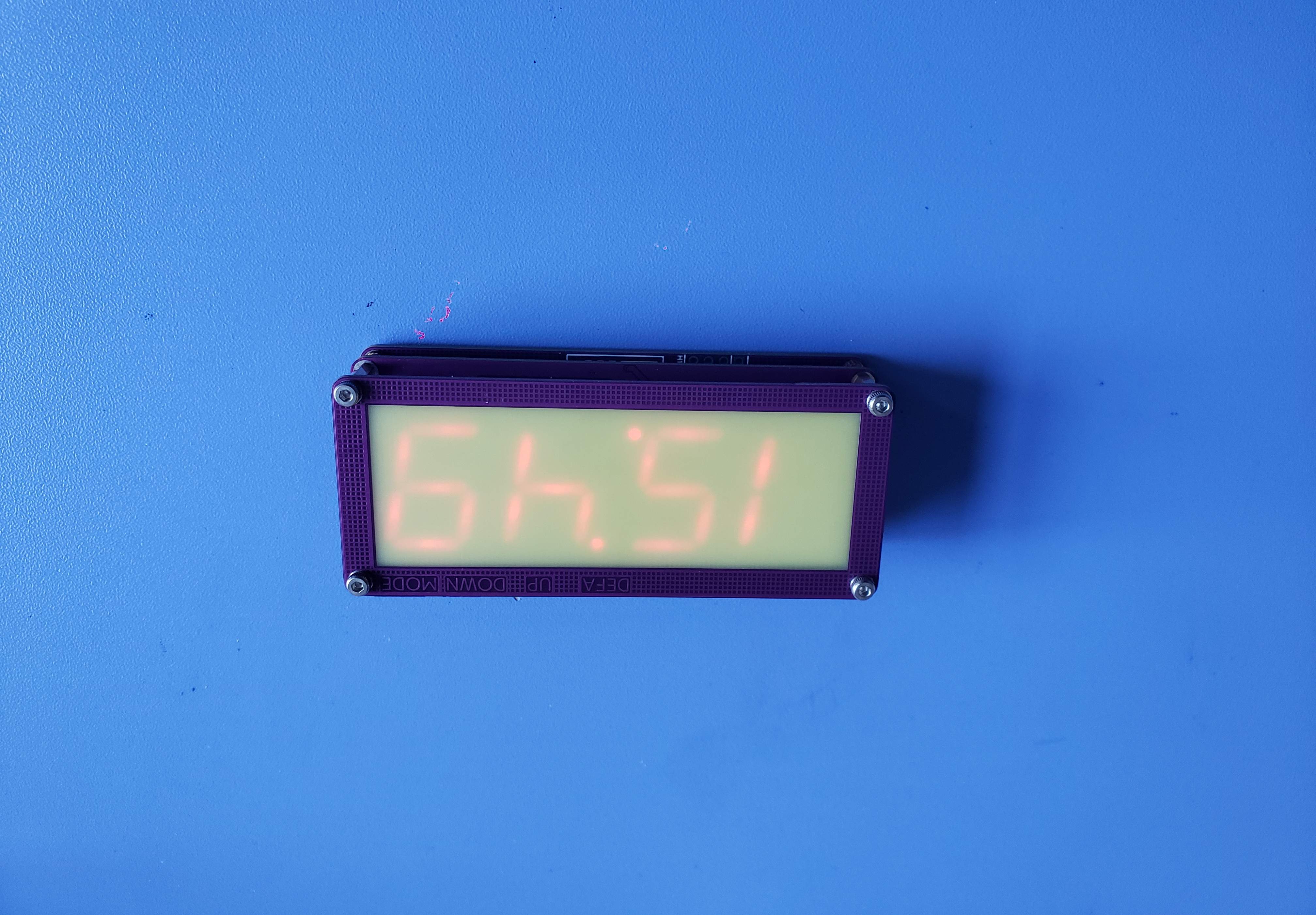

characteristic
TM1650 drives 4-digit 8-segment 0.8-inch digital tube for display;
Onboard DS1302 clock IC, accurate timing;
Onboard buzzer is responsible for reminding time;
It can realize time display, countdown display and positive timing display;
The onboard 400mah battery can be used for 13 hours to meet the needs of daily travel and school; the reserved battery space is 28 28 6mm
Onboard 4056 series charging IC and dual power switching circuit for convenient charging;
Among them, R7 is the charging configuration resistor, which can adjust the charging current. The calculation relationship is:
When adjusting R7 to 12K, the charging current is 0.1A, 100ma, which will neither cause too much heat nor charge too slowly.
Battery detection and low battery reminder
You don’t need to solder BAT54C, just connect VB and VCC directly;

physical object
positive effect
Reserved battery compartment
Charging, power switching, and battery voltage division
negative overall effect
Top view, now the reset button has been ripped off
