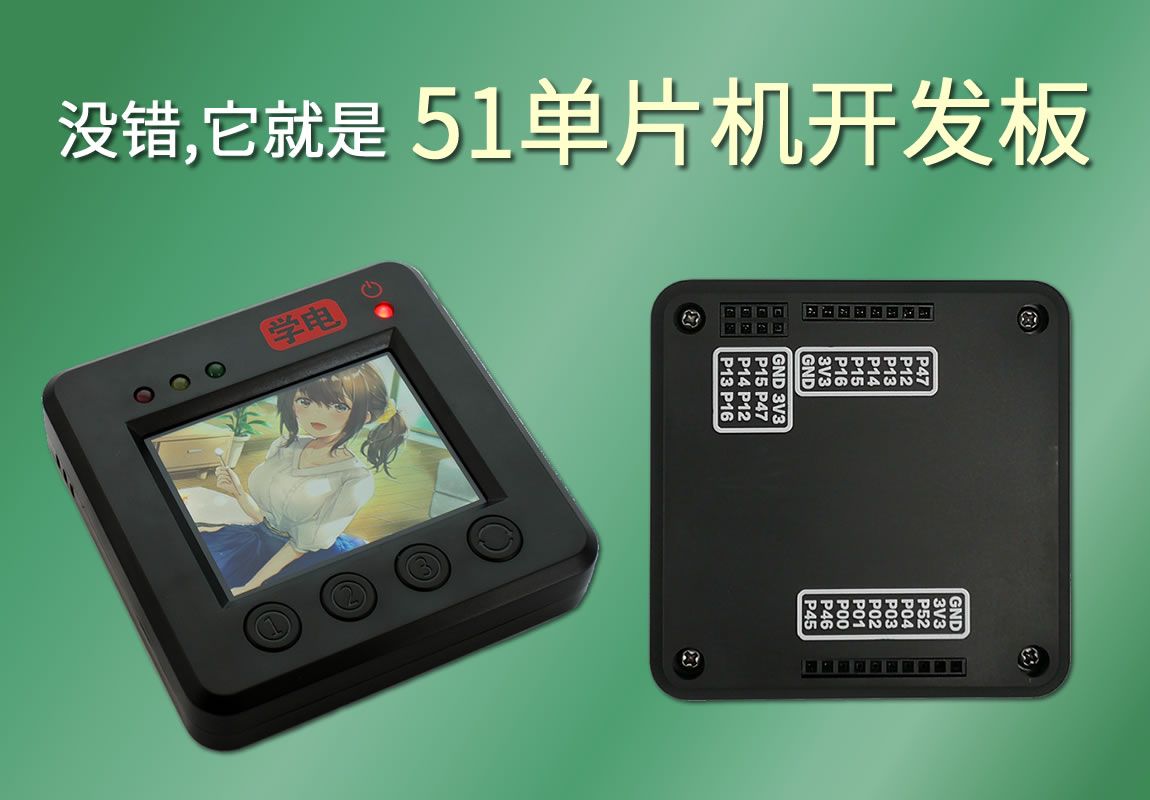

Based on the above considerations, the schematic diagram of the development board is released.
Make the PCB.
Just 3D print a shell and put it on.
According to actual measurement, the 3D printed shell is not resistant to falling. As long as it falls on the ground, the chance of breaking is very high. Don't ask me how I know...
Since we want to make product grade, we'd better find a mold factory to make the shell. Although it's a bit expensive, the shell made by the mold has a very good feel and quality, and is also very thin...
For those pins on the back, it is better to add the pin names to facilitate us to connect external modules. As follows:
Because the space on the back of the shell is limited, I can only write its IO pin names. For those multiplexed pin names, just look at the picture below. I want UART, I2C, SPI, etc., all available.
