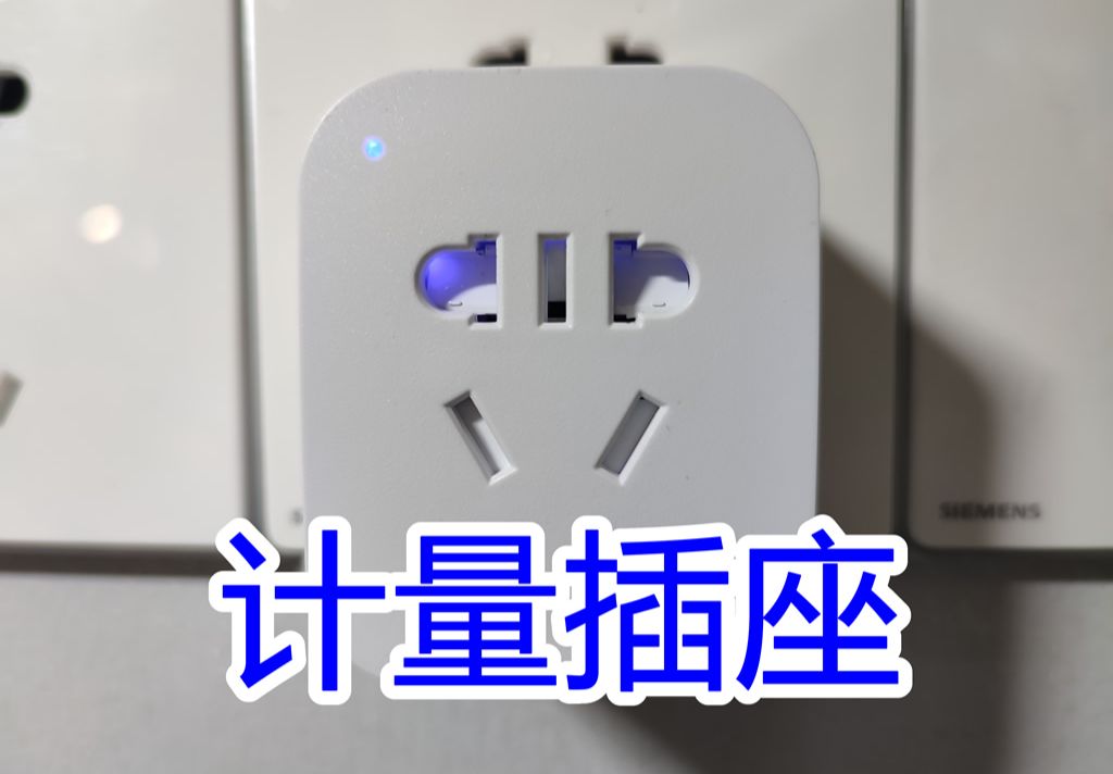

Statement:
This project is improved from my previous project: [Verified] Magnetic holding WIFI smart socket (220V10A) https://oshwhub.com/oldfox126/ci-bao-chi-wifi-zhi-neng-cha-zuo The biggest problem in production is neither hardware PCB nor software writing, but metering calibration (the value output by the metering chip is quite different from the actual value). Without professional power calibration instruments, it took a lot of effort to calibrate to the current level, which is far from perfect. The metering data of this socket can only be used as a reference and cannot be guaranteed to be 100% accurate.
I am a software major, not a student of electronic hardware, but an amateur. Therefore, I may not know a lot of basic hardware knowledge. If there is anything wrong with the circuit diagram, I hope you will give me some advice. Thank you very much.

1. This socket requires 2 PCBs, and the thickness of the 2 PCBs is 1mm. The PCB of ESP12S is located at: https://oshwhub.com/oldfox126/esp12s-shuang-mian-zhi-cha-mo-kuai-2x6p
2. The metering chip uses HLW8032, which is a high-precision metering IC. 3. Use an isolated power supply to output 5V to power the metering chip.
4. The relay is a magnetic latching relay, which only needs to be powered at the moment of action, and does not need to be powered to maintain the state later. Therefore, this socket has excellent power saving performance, and the overall power consumption is only about 0.65W, and long-term use will not cause the relay coil to heat up.
5. If during the PCB boarding process, the manufacturer prompts: the middle milling slot connection is too small, the board will be broken, etc., please reply: I have known and accepted the risks brought by this reason, please produce directly according to the Gerber file, thank you!

Hardware update instructions:
2022/11/18
1. In order to make the raised plastic block on the plastic back cover top on the PCB, the position of the components was adjusted to bypass the four raised plastic blocks. But the largest protrusion in the middle still cannot be bypassed, so the protrusion can be cut off. Thanks @skcks 2. According to the design scheme of using the neutral line N as the reference ground designed by the big brother @EHE in the comment area, the schematic diagram and PCB diagram were redrawn. In theory, the live wire L is better as the reference ground, but when arranging the PCB, it was found that the component layout needs to be swapped left and right, which is too much work and easy to make mistakes. The live wire L is temporarily abandoned as the reference ground. Thanks @EHE
2022/11/11
According to the comments of the big brother in the comment area, the improvements are as follows:
1. The 5V isolated power supply is removed. However, because the 5V sampling signal needs to be converted to MCU 3.3V, the optocoupler cannot be saved. Thanks @LZGD
2. The PCB height is increased by 1mm. Thanks @小菜比
3. All traces are converted to arc traces. Thanks @小菜比
4. The position of the sampling resistor is readjusted. Thanks @小菜比
5. GND copper is added. Thanks to @小菜比
6. Because the 5V isolated power supply was removed, GND was directly connected to one end of the 220V. I felt that burning the pins became very dangerous, so I cancelled it.
