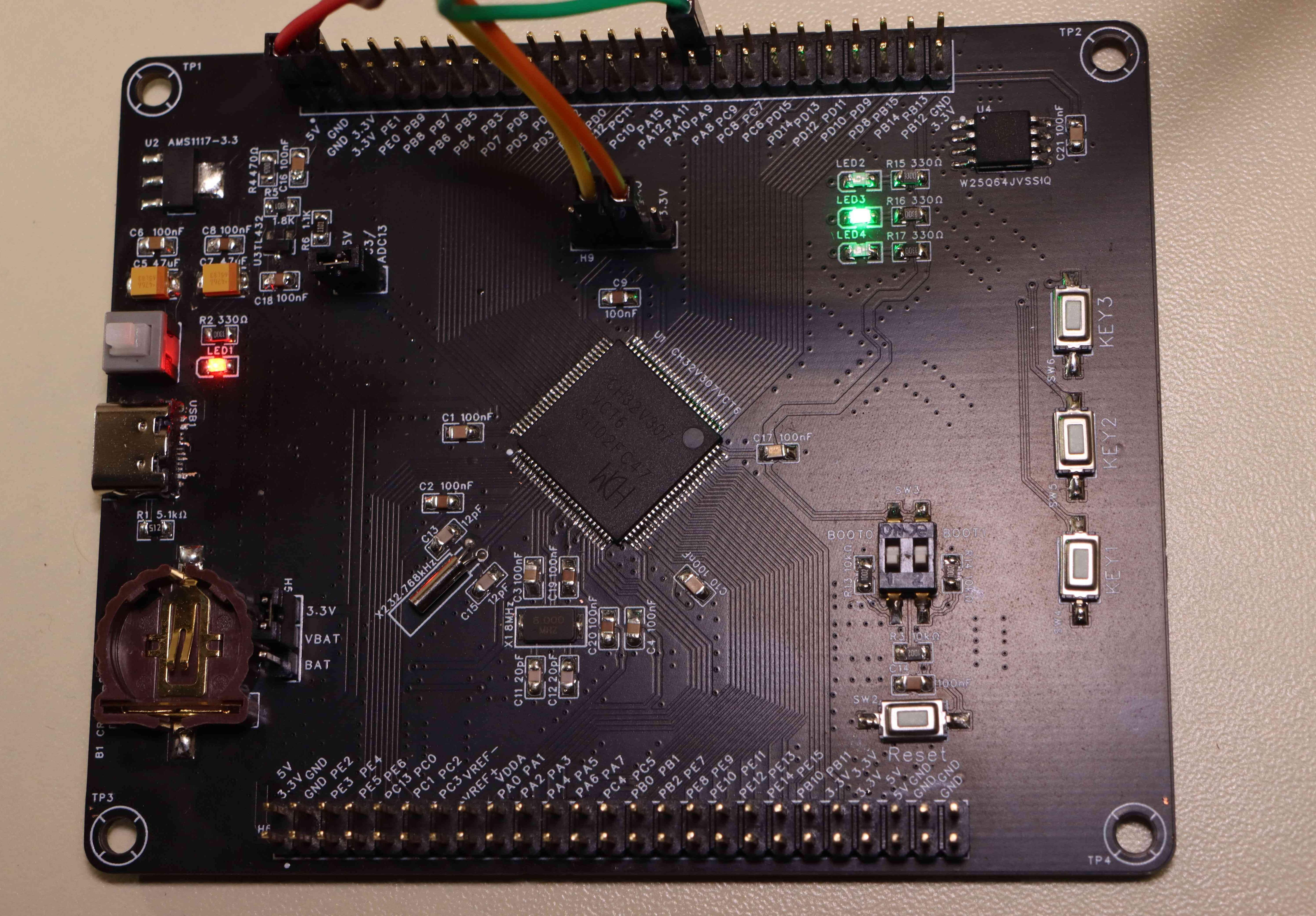

## Actual picture
![1688143821239.gif] ![IMG_5720.jpg] ![IMG_5724.jpg] ![IMG_5725.JPG] ![IMG_5727.jpg]

**Top layer:**
The 1.25V (measured about 1.246V) voltage reference of TL432 can be connected to the ADC13 interface of GPIOPC3 through the H8 jumper cap.
SW3 controls the BOOT0 and 1 bootstrap pins, and can set the bootstrap mode (see the chip manual 2.5.2 on-chip memory and bootstrap mode for details). Just set them to low level (off).
The H9 pin header is used to connect the WCH-Link burning code.
The H5 pin header is used to select the power supply of the VBAT pin. If there is no battery inserted, it can be connected to the 3.3V power supply through the jumper cap. If a battery is inserted, it can be connected to BAT.
