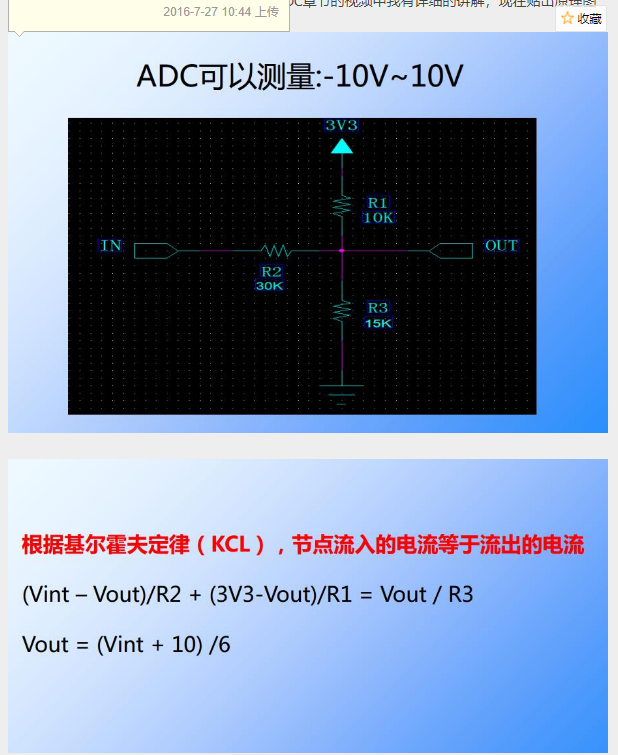

Function 1: The bidirectional current sampling part uses la25 Hall sensor to collect current, and at the same time, the basic principle of increasing the sampling voltage based on Kilhall's current law is shown in Figure 1 below. Figure
1: Principle of voltage increase
The relevant parameters used in this design are shown in Figure 2 r1=20K r2=20K r3=15K *
Vout=1.5V+0.4 Vin **
Figure 2 The design parameters used in this design
