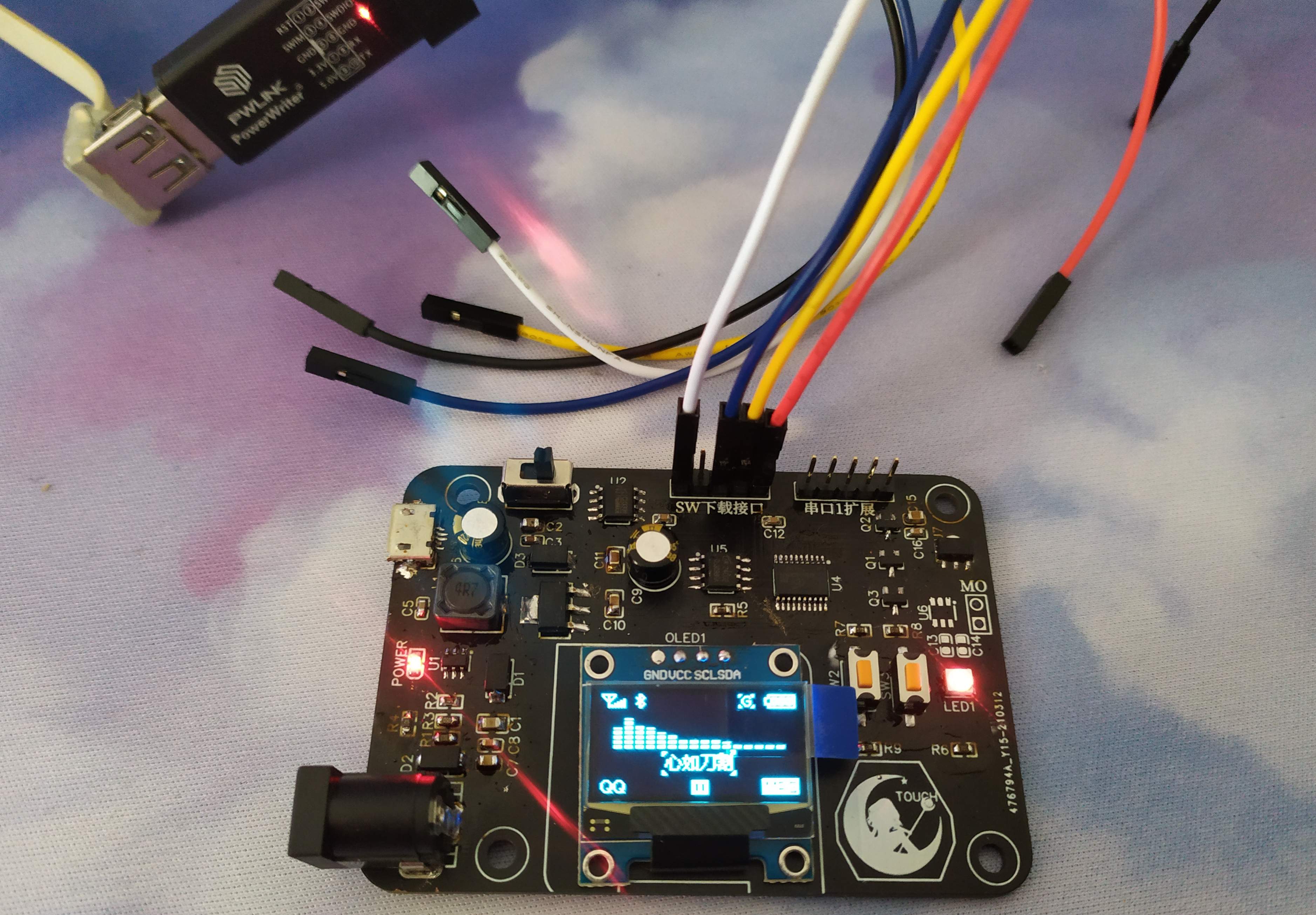

Figure 1: Overall renderings

Show results:
Figure 2: SW download circuit
Figure 3: Startup interface
      Figure 4: Switching the adjusted color
                            Figure 5: Increase the selection color value (*note1)
Precautions:
        *note1: Recording the reflection of the mobile phone causes the LED1 on the right side of Figure 5 to always record white (it is truly colorful to the naked eye). For the reason of recording, please watch the color of the reflection of the finger change with the numerical value.
