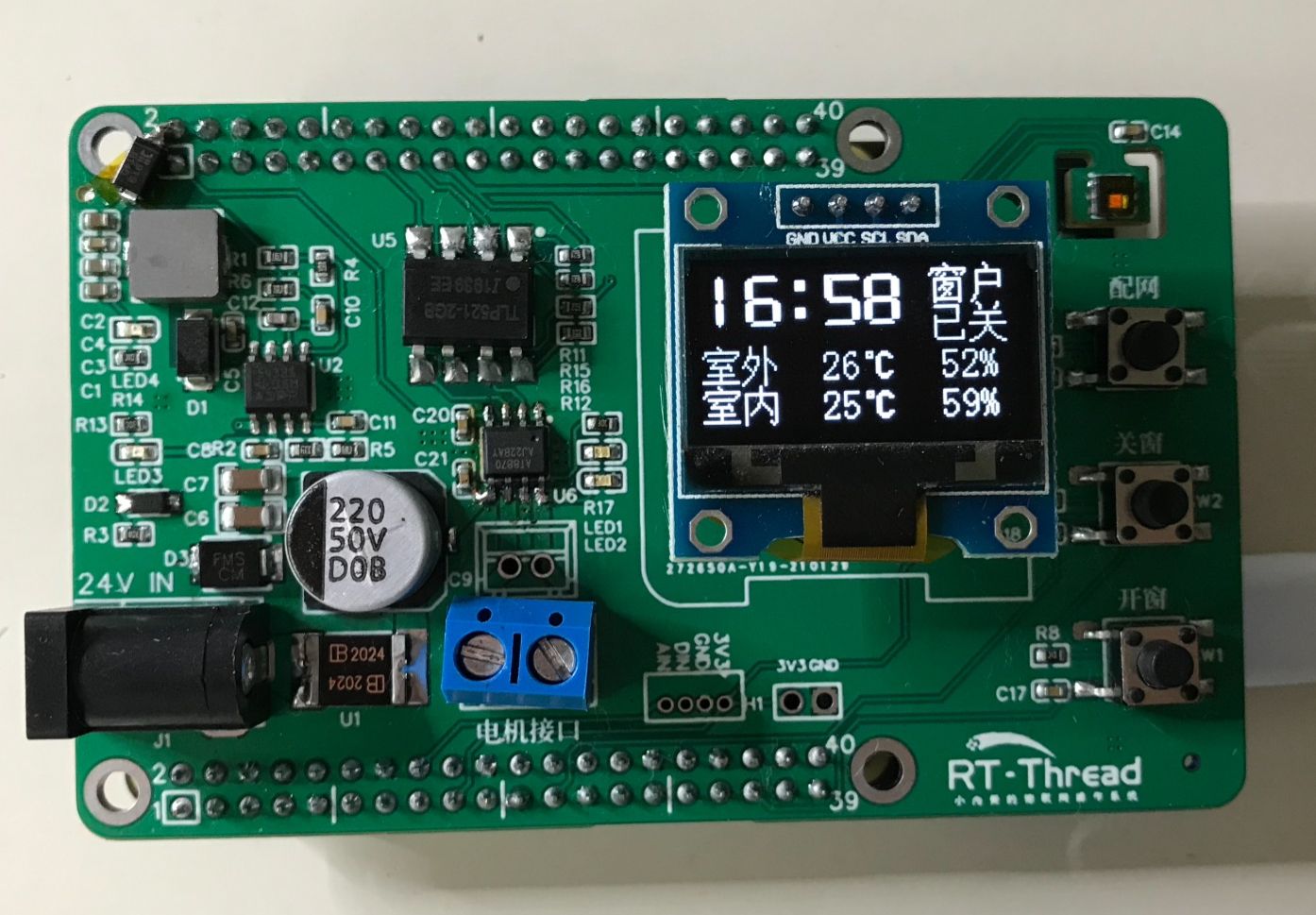

I have heard of the name RTT for a long time, but have never had the opportunity to contact it. Taking advantage of this opportunity, I can just add a skill. It is said that RTT's software package can be easily connected to Alibaba Cloud and other platforms, so I decided to participate in this event with the attitude of learning RTT. It is planned to use the RT-Thread software package to connect to Alibaba Cloud and control the forward and reverse rotation of the window pusher push rod motor to achieve intelligent control of windows. After actual measurement, it was found that the current that the AT8870 can provide is still too small, and it cannot fully drive the push rod even under no load, so the video demonstration can only be done with a small motor. There is a chance to make a relay version to control the fader.
We originally designed a temperature and humidity sensor, but Tuya's second training camp happened to be opening at the same time, and it also focused on the MCU development model. What a coincidence, and it matched perfectly with the ART-Pi activities. So I temporarily changed the design and reserved the location of the graffiti module. One board can participate in two training camps, with different focuses on both sides.
This project iterated on two hardware versions. First version: L298N H-bridge chip + toggle switch dual power supply switching + temperature and humidity sensor + light sensor + dual optocouplers. Second version: AT8870 H-bridge chip, remove the toggle switch, add OLED interface and location, remove the light sensor. Remove an optocoupler. Add three buttons.

The original plan used an electronic push rod, which can be driven directly by 24V, and the positive and negative poles can be reversed to move in the opposite direction. As a result, I used an AT8870 during the test. It seems that the AT8870's driving capability is not enough, so the demo was changed to drive a small current motor. It is still OK to use it to pull a curtain or roller blind. AT8870.pngThe most important thing is that when there is no bottom board, it can also be used as an independent motor driver board! !

Instead of using the common SHT31, TI's HDC1080DR is used, and it is cheaper. Finally, it was designed to the upper right corner of the board, isolated by slots, and the bottom through holes were opened to minimize the impact of the board's own heating on the temperature measurement. image.png

6. OLED display
image.png Display content:
  • Clock (using the hardware RTC of STM32H750, and using the NTP function to synchronize the clock regularly).
  • window status
  • switch status
  • Real-time weather (using Amap Weather API)
  • Indoor temperature and humidity (provided by onboard HDC1080)
  • When pressing the button, it will prompt whether the window is opening or closing. The OLED driver chip is SSD1315, global refresh mode. The initialization code is slightly different from the popular one on the Internet.

  1. Try to isolate the power supply of the motor part, otherwise it may cause interference to the OLED display.
  2. If it is not isolated, at least add an expansion board 5V output anti-backflow diode.
  3. If you use applications such as push rods that do not require speed regulation, relays are the best.
