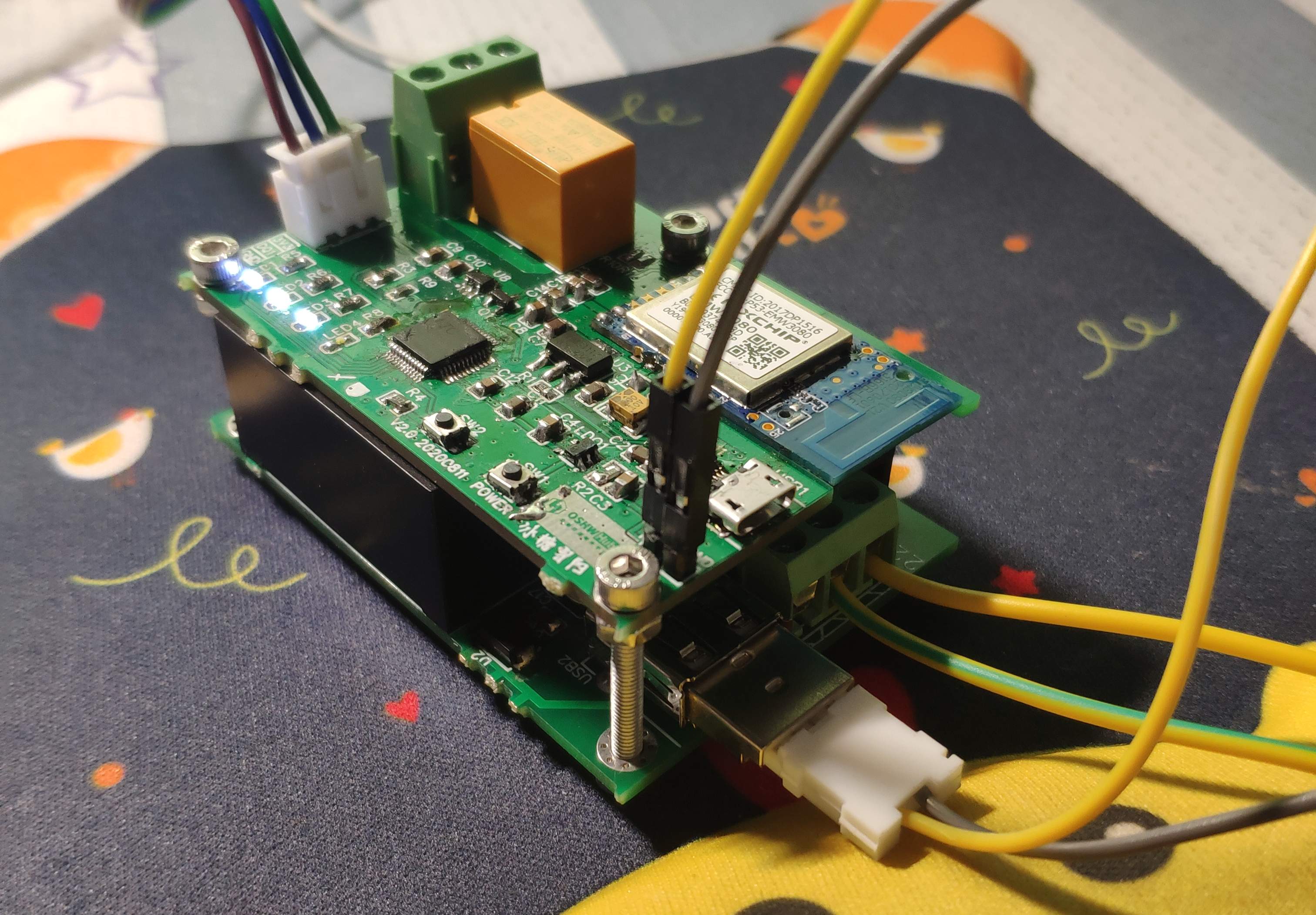

5. Physical production

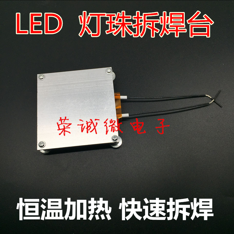

I returned to school on August 16, and got the PCB board and components under heavy epidemic prevention obstacles from the security guards. I went back to the dormitory and soldered. This was the first time I used solder paste and a heating plate to solder.
Due to the power limit in the dormitory, when I was using the heating plate shown in the picture below, the power in the dormitory was cut off and I was almost punished.
Back to the topic, the PCB that was soldered for the first time, its 51 minimum system part was very normal, and then the firmware was updated for the EMW3080 (how to update the firmware? https://www.yuque.com/lingyao/jing/isdnec ). But at 23:00 in the evening, the test found that the TX and RX of the serial port 2 of the 51 (the serial port that communicates with the EMW3080) were short-circuited. I tried to repair the soldering countless times, but the error was not corrected, so I soldered a second board (below). The picture above is newly welded), I didn’t sleep all night.
At 4 o'clock in the morning on August 17, there was actually no big problem when soldering the second piece. I didn't use solder paste. I used a soldering iron and solder wire, but the small USB interface was a big problem. [ I applied too much tin, and the tin entered the inside of the USB connector, causing the data cable to be unable to be inserted] , and the serial port download program became impossible. This mistake is very fatal. The components on my hand are only enough to solder two boards. If I can't solve it, it will be equivalent to losing the qualification of outstanding students.
The micro USB interface is difficult to remove. I spent a lot of effort to remove the micro USB connector with a red soldering iron tip, but this also caused some damage to the printed circuit. Fortunately, the TX and RX lines are still there. With trembling hands, I reconnected the micro USB connector several times, and finally successfully connected it. Finally, with the addition of external power supply (pay attention to the common ground), the second board was successfully resurrected and the program can be downloaded normally. I downloaded the program (universal) provided by Song Gong.
Stayed up all night, so exhausted. I took a short nap before configuring the network. I still don’t quite understand the principle.
At 6:30 in the morning on August 17, I found where to connect the network. It turned out to be here. Scan the QR code in the picture below for the first time to download the app. Then scan it again in the discovery device and you will be prompted. You enter the password for the WiFi you are connected to.
At 12:11 on August 17, after the PCB is powered on, send the triplet information through the serial port in the following format. You can get {"CMD":"OK"}, indicating that the writing is successful.
Then send {"CMD":"Read"} through the serial port to get the written triplet information and check whether it is correct.
8月17日晚20点,听了宋工的讲解,发现这里要设置为一键配网,如下图,修改后,参考直播课的演示,即可正常配置此设备连接阿里云生活物联网平台
配置好后,测试继电器通断的控制,发现继电器没有反应,依次测试51引脚输出电压,反相器和继电器驱动器的各引脚连接情况,发现是驱动器接地引脚虚焊(下图),补焊之后,继电器控制功能回复正常。
至此,实物制作告一段落。
