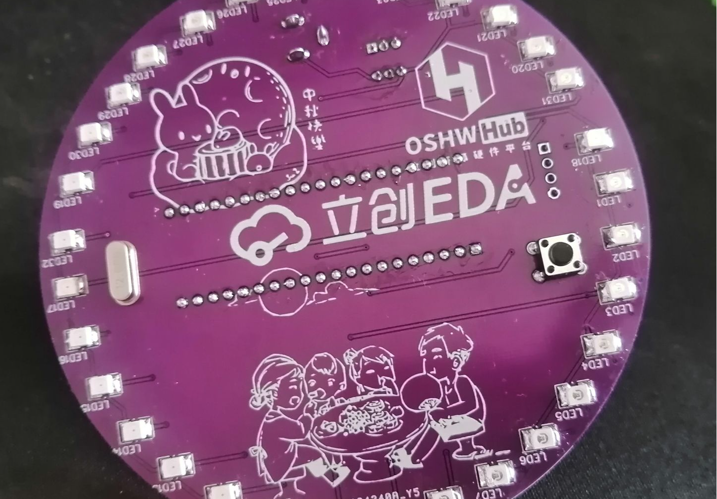

Project introduction: The Mid-Autumn Festival is approaching, and a simple and easy-to-use mooncake lamp is undoubtedly the best choice for our beginners to express blessings. This project is a mooncake design based on the ATC89C52RC microcontroller. A single microcontroller system composed of light-emitting diodes, crystal oscillators, reset, power supply and other circuits and necessary software. Simple yet unique, a must-have item for students with zero basic knowledge.
Hardware part:
It can be seen from the hardware schematic diagram that if you want LED1 connected to the P1.0 port to light up, then you only need to change the level of the P1.0 port to low level; on the contrary, if you want to connect When LED1 in the P1.0 port goes out, the level of the P1.0 port must be changed to high level; similarly, the lighting and extinguishing methods of other LEDs are the same as LED1. Therefore, to realize the running water lamp function, we only need to turn on and off the light-emitting diodes in sequence.
