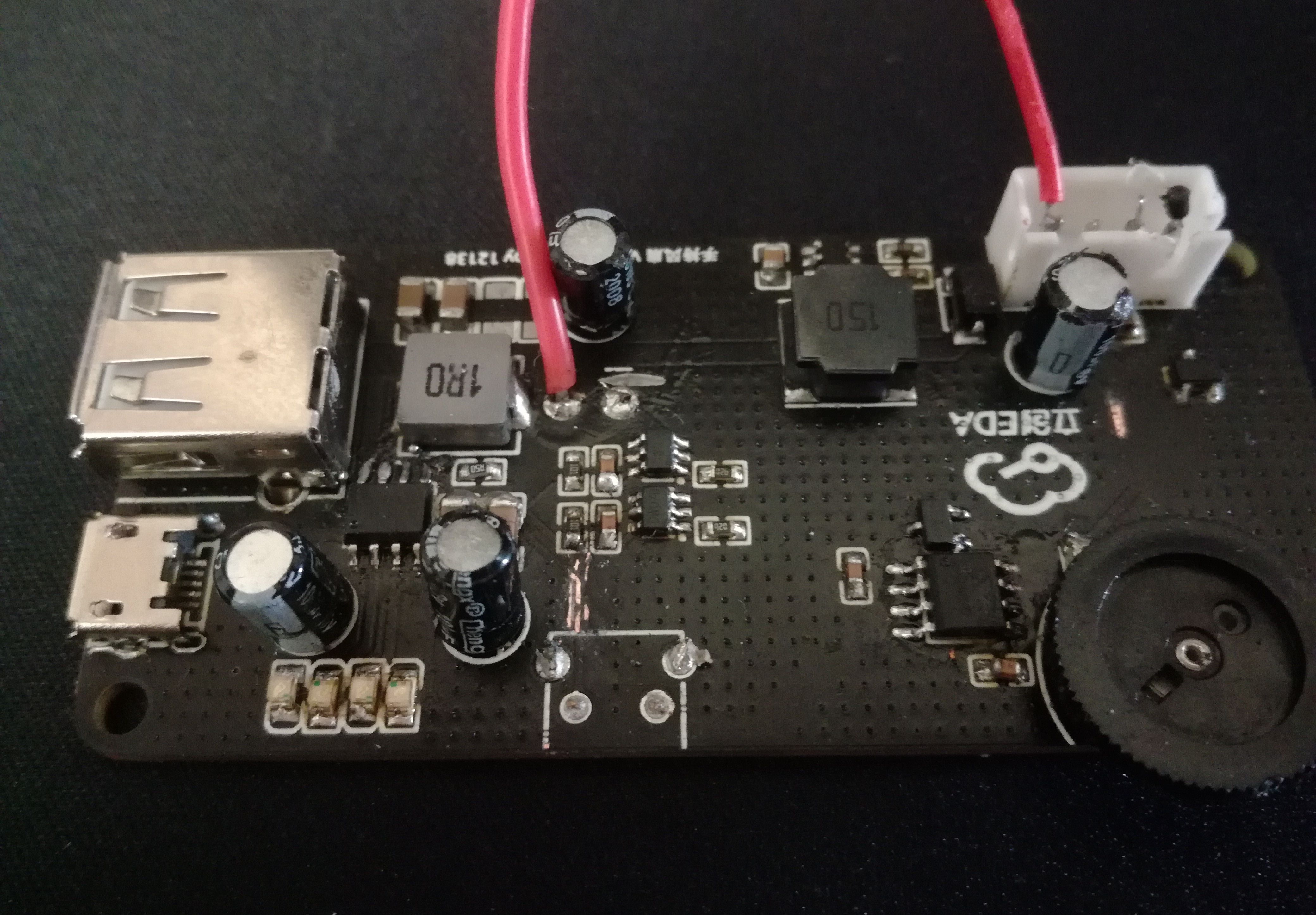

2020/5?/1:: When I saw the collection order was extended, I took advantage of it.
2020/5/5: Used most of the original circuit directly and finished it in two hours
2020/5/6:pcb board making
2020/5/10: Received the pcb (but there is no time for express delivery, and the components have not been purchased yet)
2020/5/14: Place the next component
2020/5/21: All completed
2020/5/23: Lichuang’s 1 yuan free fan is so fragrant  It doesn’t matter whether you do this thing or not.
  • Single lithium high-power solution, compact size, strong wind power
  • Support power display
  • Integrated battery protection chip to prevent over-discharge
  • Using IP5306, the charging heat is small and the voltage boost is more stable.
  • The charging current is as high as 2A, and the heat generation is small. The current exceeds the 500mA or even 300mA solutions on the market.
  • With stepless speed regulation function, non-external PWM method (requires fan support)
  • Shut down "0" power consumption, effectively extending battery life (current is very small, a few uA)
