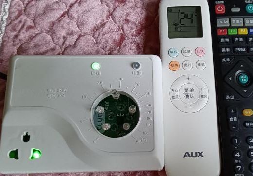

Power on successfully. Upper shell:
Open Tuya Smart APP and start networking:
