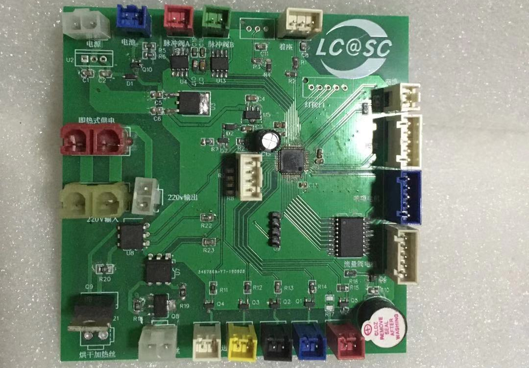

2. Describe the challenges faced by the work and the problems solved; This smart toilet uses RTOS this time due to its large number of functional modules, and uses the freeRTos that comes with stm32cubemx, but the selected chip The ram of stm32f030c8tx is very small, and it is quite tight after running the system. Therefore, many places that should have used threads are now completed with timer scanning. When looking at the software, don’t have too many problems in this regard. (We welcome all kinds of communication at the same time. After all, this industry is very marginal in electronic products, with many functions and many manufacturers in demand). In addition, there are buttons and seat temperature ADC reading, because there are a total of 12v, 10v (battery variable), 5v, 3.3v on the motherboard. , 220vac, so the interference is very large. I have used interrupts to trigger the buttons before, but they often trigger for no reason, and the buttons jitter, so I use a continuous scanning method, the same is true for ADC, and at the same time do data edge processing such as high and low. Bluetooth communication part It is also more difficult, because some third-party imitating bt4.0 directly uses cc2541 to open the port and transparently transmit data, and then there are often some strange problems when debugging, restarting, and the phone loses link. I will rewrite this if I have the opportunity in the future, and provide The main control chip can actively disconnect the BT from the mobile phone and other functions. After all, this Bluetooth chip has its own MCU function, which is more than enough to process some data.
3. Describe the key points involved in the hardware and software parts of the work; Hardware part: The smart toilet integrates many level power supply, so there is a lot of interference. The typesetting is still relatively particular. Of course, due to personal issues, the work may be relatively ordinary. Many switches have reverse current when they are turned off, so there are a lot of tests in the selection of switch tubes. And basically all of them are selected. It has freewheeling, but the consumption of the switching tube is not very important. Since the gate resistors are across voltages, they are selected relatively large, mainly because they are afraid that the current will flow back to the chip when something goes wrong. Software part: This time, stm32cubemx is used. For initialization work, the LL library is used to implement functions normally, and freeRTos is used for the system. The mobile terminal uses flutter and the third-party library shared_preferencesflutter_bluecupertino_iconssqflite. As an accessory product, the mobile terminal will not be introduced in detail (mainly actual control, and recording health data).

Upload the picture of the work; (the competition logo must be on the PCB and take a photo to upload. If If you ignore it, you will be deemed to have given up the competition.)
Back of
the main control board
* 6. Demonstrate your work and record it as a video for upload; (The content of the video must include: introduction of the work; function demonstration; performance test; close-up shot of the competition logo on the PCB. If you do not show it, you will be deemed to have given up the competition. )
