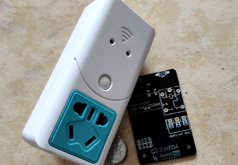

IMG_20210531_122252.jpg Finished product display

7 Circuit board welding
IMG_20210530_183809.jpg Pictures of the front side of the proofing circuit board and the front side after soldering the components. Pictures of IMG_20210530_183743.jpg the back side of the proofing circuit board and after the components are soldered. IMG_20210530_183841.jpgIMG_20210530_183859.jpgIMG_20210530_192254.jpg Installation diagram of the circuit board in the casing.
