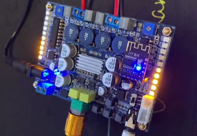

  • 1. After a week, the sample finally came back and was welded. When it came back after welding, it turned over and the speaker could not work. After some research. I found that the mute pin on the schematic diagram was connected incorrectly.
  • The sticker shows that this is the correct connection, and the original version was connected to it.
  • Question 2. The schematic diagram of LM3915 is found on Taobao. There is a problem. There is a problem with the input resistance of the audio source. After connecting, the speaker sound is very small. The reason is that the resistance is very small and the left channel is basically facing the ground, causing the speaker sound to be small. The solution is not to connect the 10R resistor or increase the resistance.
  • Finished product display
  • 1. Manually pull the wire here to change the mute pin circuit.
  • 1. What I use below is the horn that has been with me for many years. I use it to crack walnuts and use it as a hammer. The speaker is still usable and in good condition. It is already scarred. I am using 15W impedance 8 ohms.
  • Problem Description
  • 1. The latest schematic diagram and PCB have been updated. Update content: 1. Modify the silent pin circuit. 2. Add a high current toggle switch.
  • 2. Use a better power supply to power the amplifier. It is recommended to use a 15V-24V, 3A or above regulated power supply.
  • 3. If you want to drive a high-power speaker, the power amplifier chip should choose a large aluminum sheet for heat dissipation. The one in the picture is too small to hold down.
