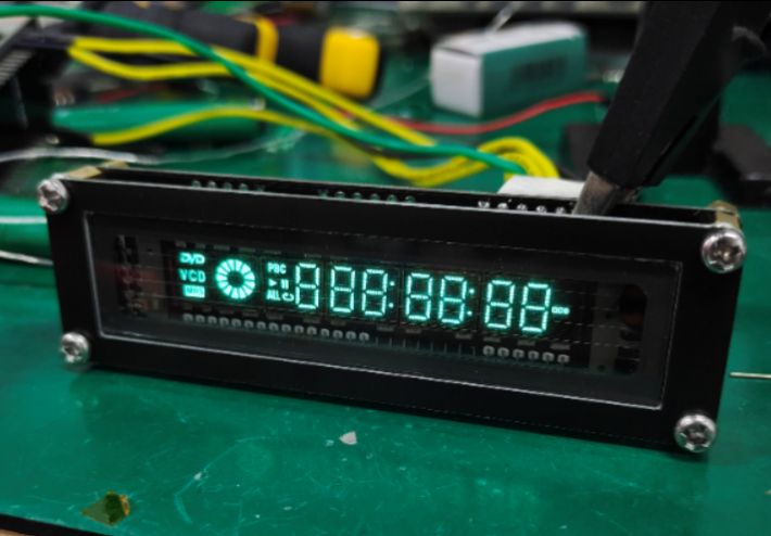

  • EEI TECHNOLOGY VFD series project, DL18-0615 VFD drive base plate.
  • The improved Cuk topology power supply scheme has low starting current and high efficiency, which cannot be compared with Buck-boost negative voltage and transformer.
  • The 120K 50% square wave generated by the multivibrator is sent to UCC27517 to realize the charge pump to drive the filament.
