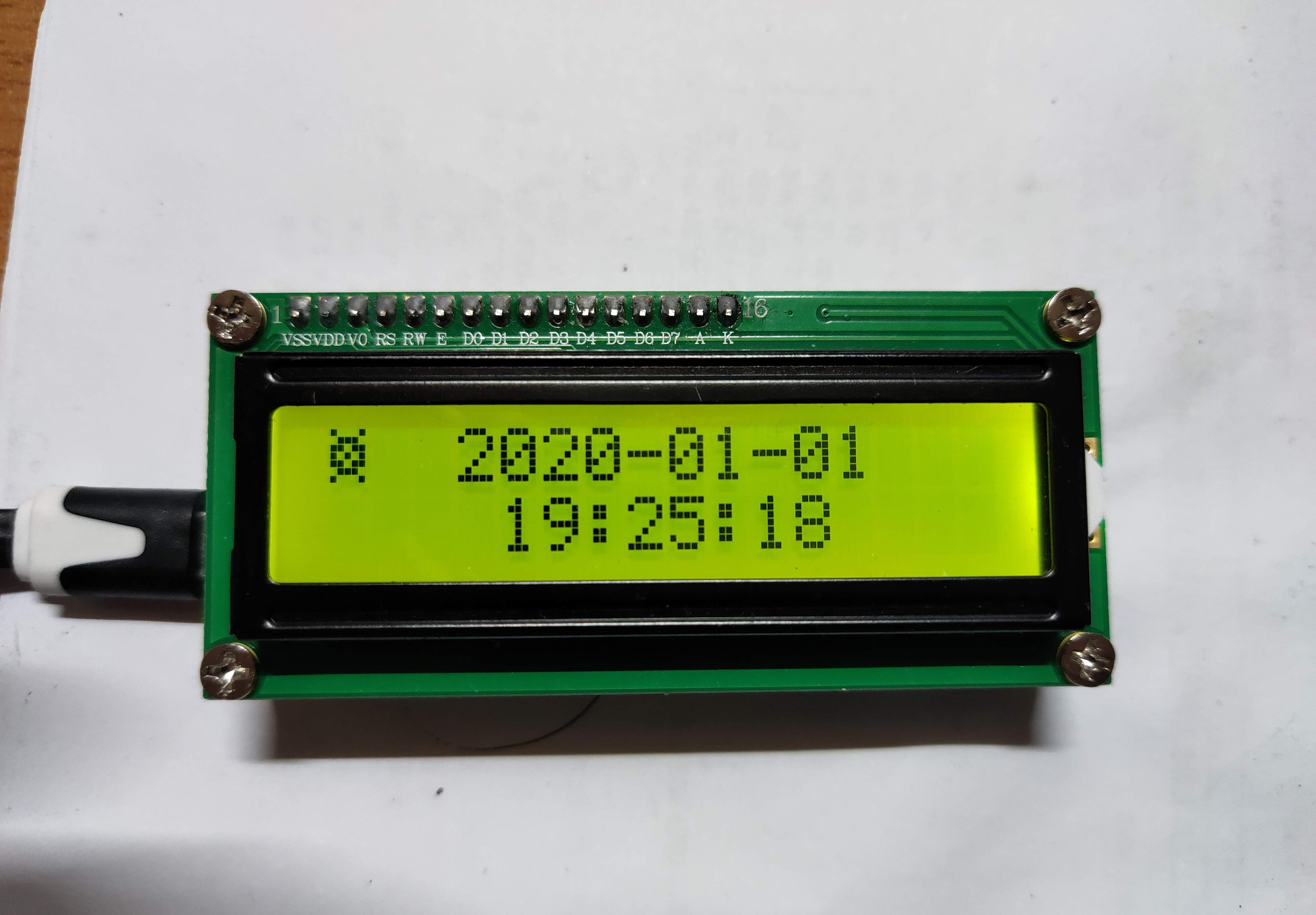

lct.png As shown in Figure 2-1, this system uses STC89C51RC microcontroller as the core. The clock chip provides time and date information. The temperature and humidity detection module collects temperature and humidity information. The function key input cooperates with the main control chip to realize various functions. LCD1602 is used as the display. Information and human-computer interaction interface are provided, and the buzzer can realize various prompt sounds.
  • 1 Hardware design
1.1 Display module
The display module uses LCD1602 liquid crystal screen. LCD1602 liquid crystal display is a widely used character-type liquid crystal display module. It consists of a character-type liquid crystal display (LCD), main control and drive circuit HD44780 and its extended drive circuit HD44100, as well as a small number of resistors, capacitors and structural parts assembled on a PCB board. The circuit uses pin headers to connect the LCD1602 display module to the circuit. The circuit diagram is shown in Figure 3-1.
Table 3-1 shows the pin function diagram of LCD1602. Its number corresponds to the number of the female header U3 port. Port 3 is used to adjust the contrast of the liquid crystal. The contrast is the weakest when connected to the positive power supply, and the contrast is the highest when connected to the ground. If it is too high, a "ghosting" phenomenon will occur, so a 10K variable resistor is added to adjust the contrast to make the LCD character display clearer. Port No. 5 corresponds to the R/W pin. According to the actual system function requirements, this port is directly grounded to save the microcontroller port.
