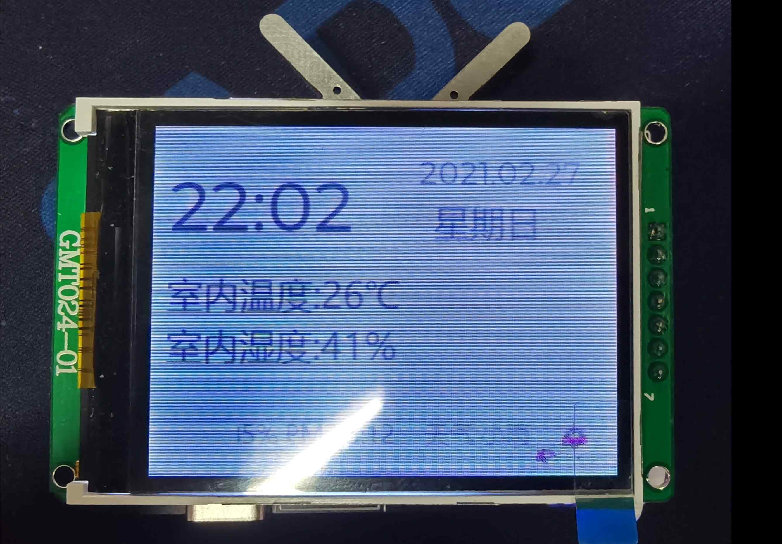

Hardware solution: The main control uses W601 chip, the temperature and humidity collection uses SHT30, the networking module uses Tuya Smart's WBR3 Bluetooth WiFi module to obtain network time and weather data, the single-button touch chip uses TTP233D, uses a 2.4-inch display, and is driven by ST7789V Software solution: Use RTThread operating system, and use LVGL for the graphical interface
The display screen displays the real-time time and weather forecast obtained from the Tuya module. The display screen displays the indoor temperature and humidity obtained by the SHT30. Supports the Tuya client to view the current indoor temperature, humidity, power and other parameters.
