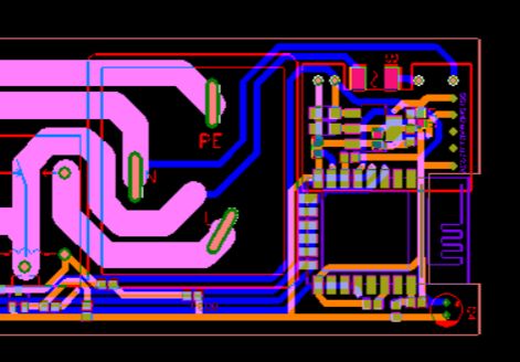

2.4 PCB prototyping and welding
        Proof the two PCB files. After proofing, weld them, and then upload the pictures.
Empty board front and back
        The Chinese characters for Zero FireWire in the picture are wrong and backwards. They have been corrected in the open source files.
        Since I didn’t take any pictures when I was doing it, the board and the case were connected together after welding, so the pictures after welding are only of the back inside the case...
Solder the reverse side
        Precautions when welding: Weld the low-voltage power supply part first, and use a multimeter to test it before continuing; then weld the rest of the low-voltage part, and weld the terminals with the wiring side facing inwards ( I did it facing out) Yes, the wire is too difficult to plug in, I plugged it in for a long time... ), power on and test the function, and continue after it is normal; solder all the other components except the socket, and put a big lump of tin on the front window part. Be careful not to block the soldering pads of the socket, but also use a multimeter to check whether there is a short circuit or anything.
