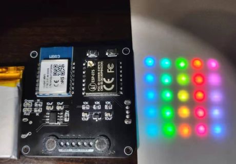

  • Tuya WBR3 (WB3S optional) module transparent transmission, MCU solution
  • 8 x 8 W2812 mini, 35x35mm full color LED display
  • In order to maintain the volume, it is designed in two PCBs, and the USB-UART is external
  • TP4056 1A charging circuit
  • Powered by single lithium battery, 803040 battery, 1200mah
  • Low voltage drop LDO, ME2019, 260mv voltage drop
  • External burning interface ( https://oshwhub.com/Xiaole.Tao/esp-air-burnner )
  • MCU uses ESP 8266 07S (without antenna, cheap, ARM M3, supports multiple programming languages, C, Arduino, Python, JS, Lua)
  • The battery comes with charge and discharge protection

Physical pictures of version 1.0, version 1.5 not taken, 2.0 PCB on the way
Lithium battery driven
Control board burning and debugging (magnetic burner  https://oshwhub.com/Xiaole.Tao/esp-air-burnner )
