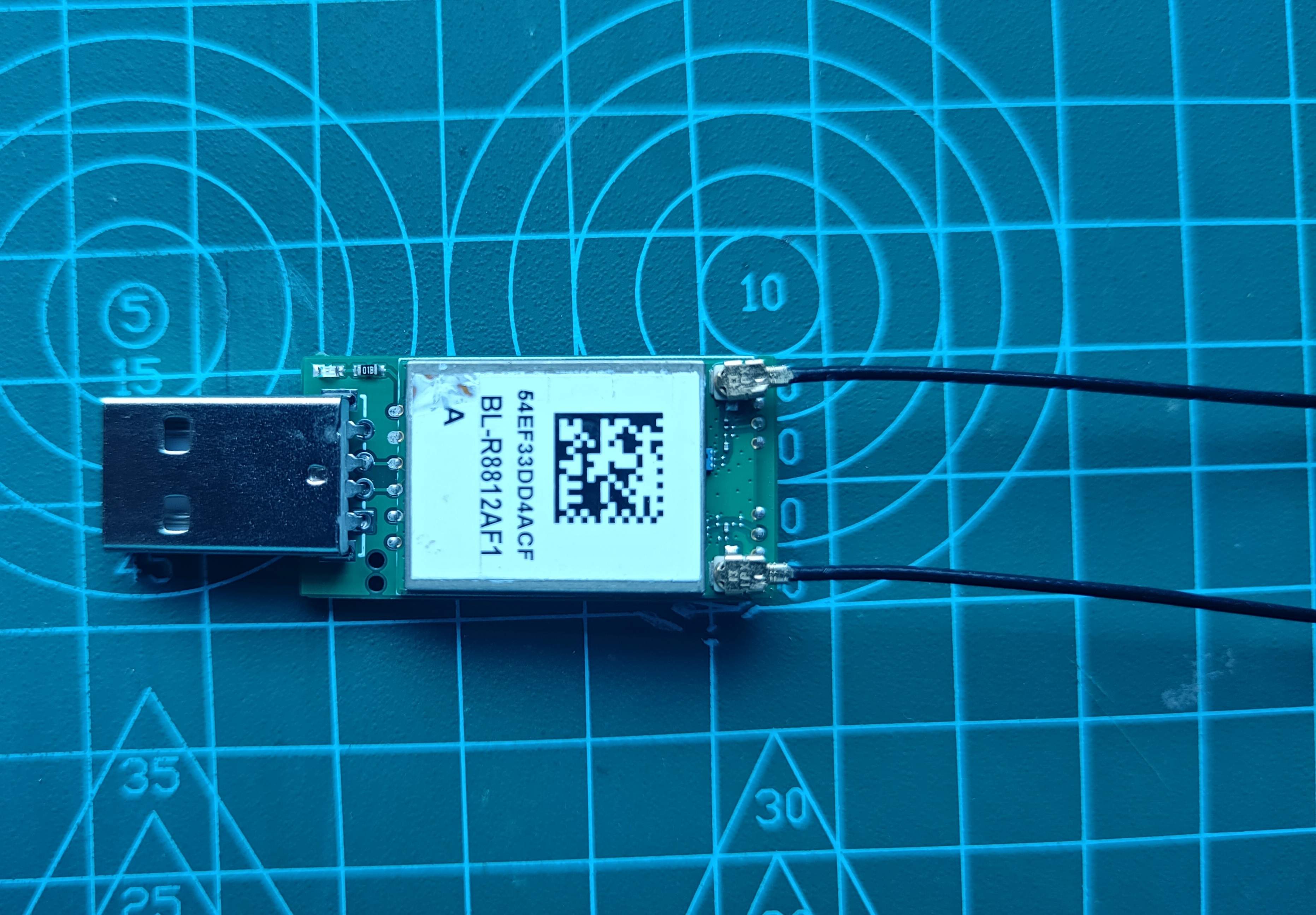

Basic information of USB wireless network card:
Model: R8812AF1-A
Chip: RTL8812AU
Frequency: 2.4GHz/5.8GHz
Rate: 867Mbps
Interface: USB2.0
Supported platforms: Linux, Windows (haven’t tried Mac yet)
Some material purchase links:
1. USB2.0 male connector: click on the text to jump to the link (white plastic 90-degree direct plug-in soldering plate male connector)
2. R8812AF1-A: click on the text to jump to the link
3. IPEX antenna: click on the text to jump to the link (2.4G 5G 5.8G dual-band all-inclusive IPEX1 generation 10CM)
4. 22*22*10 heat sink: click on the text to jump to the link
The rest of the materials can be purchased in Lichuang Mall , but do not use the BOM generated by the system to place an order. (It requires a certain understanding of the procurement of electronic components) or place an order in the Taobao store "Shenzhen Youxin Electronic Technology Co., Ltd."
For detailed information about the wifi module, please download it in the attachment. Check
the network speed tested using the router Redmi AC2100, 100M broadband, and a direct connection distance of about 5 meters without penetrating the wall. This is for reference only
