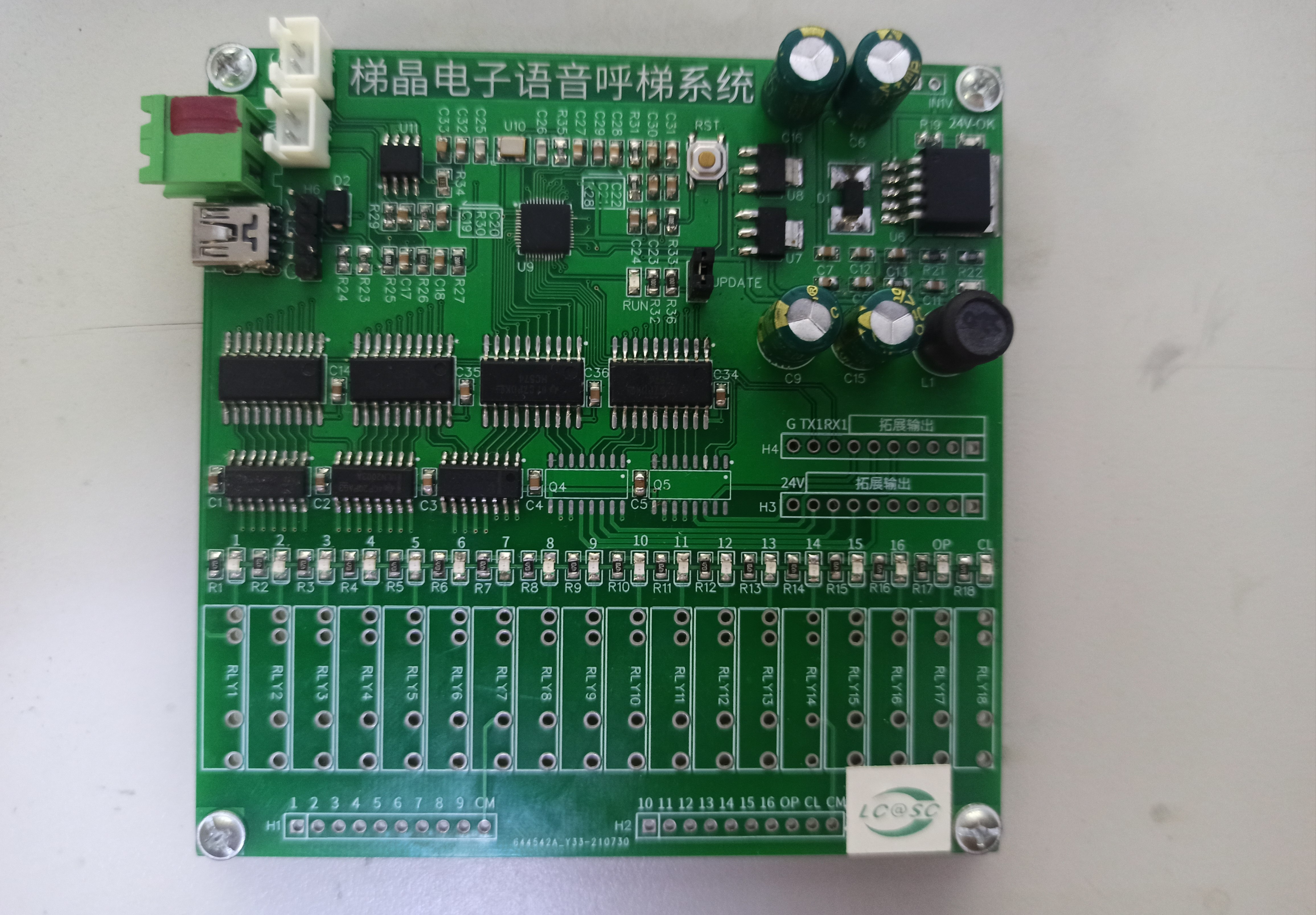

This solution uses Qiyingtailun's offline voice chip cl1122 as the core and uses voice input relay output to replace manual touch buttons.
There are many floors in the elevator, and the io of the MCU is not that sufficient.
How to do it?
Thinking hard......
hc573 outputs signals through chip select and bit select, and drives the relay through uln2003
Perfect
Theoretically, hundreds of IOs can be easily expanded, but in practice, more than 30 are enough.
