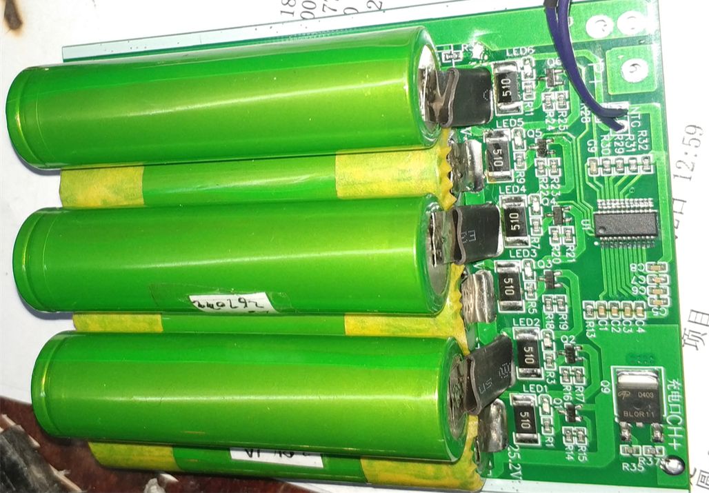

红水杯
CW1073AAAS 6-string lithium battery protection board with equalization
Basic description
The CW1073 series product is a built-in high-precision detection circuit
Lithium battery protection chip with delay circuit, suitable for 6 to 7 strings of lithium ion batteries
sub-battery or lithium polymer battery pack. Provides overcharge for lithium battery packs
Detection, over-discharge detection, over-current detection, equalization, disconnection detection
As well as charging and discharging high and low temperature protection functions.
CW1073 has built-in MOSFET driver function and supports external
The PWM signal controls the DO_PWM terminal through the DCTRL terminal.
Output to realize motor speed regulation and soft start function.
 Overcharge detection function
• Threshold range 3.750V, 4.175V~4.450V, 25mV
Step, ±25mV accuracy
 Over-discharge detection function
• Threshold range 2.100V~3.000V, 100mV step,
±30mV accuracy
 Overcurrent detection function
• Overcurrent detection 1
Threshold range 0.050V~0.100V, 50mV step,
±5mV accuracy
• Overcurrent detection 2
Threshold range 0.100V~0.200 V, 100mV step,
±5mV accuracy
• Short circuit protection
Threshold range 0.200V~0.500V, 100mV step,
±10mV accuracy
 Temperature detection function
• Charging high and low temperature protection, the temperature can be set externally
• Discharge high temperature protection, discharge low temperature protection optional
 Balance function
 Achieve 6-cell and 7-cell battery switching through SEL terminal
 Disconnection detection function
 Load detection function
PWM control driver
 Low operating current
• Operating condition 15A (25°C)
• Sleep state 5A (25°C)
 Package form: SSOP24
参考设计图片
