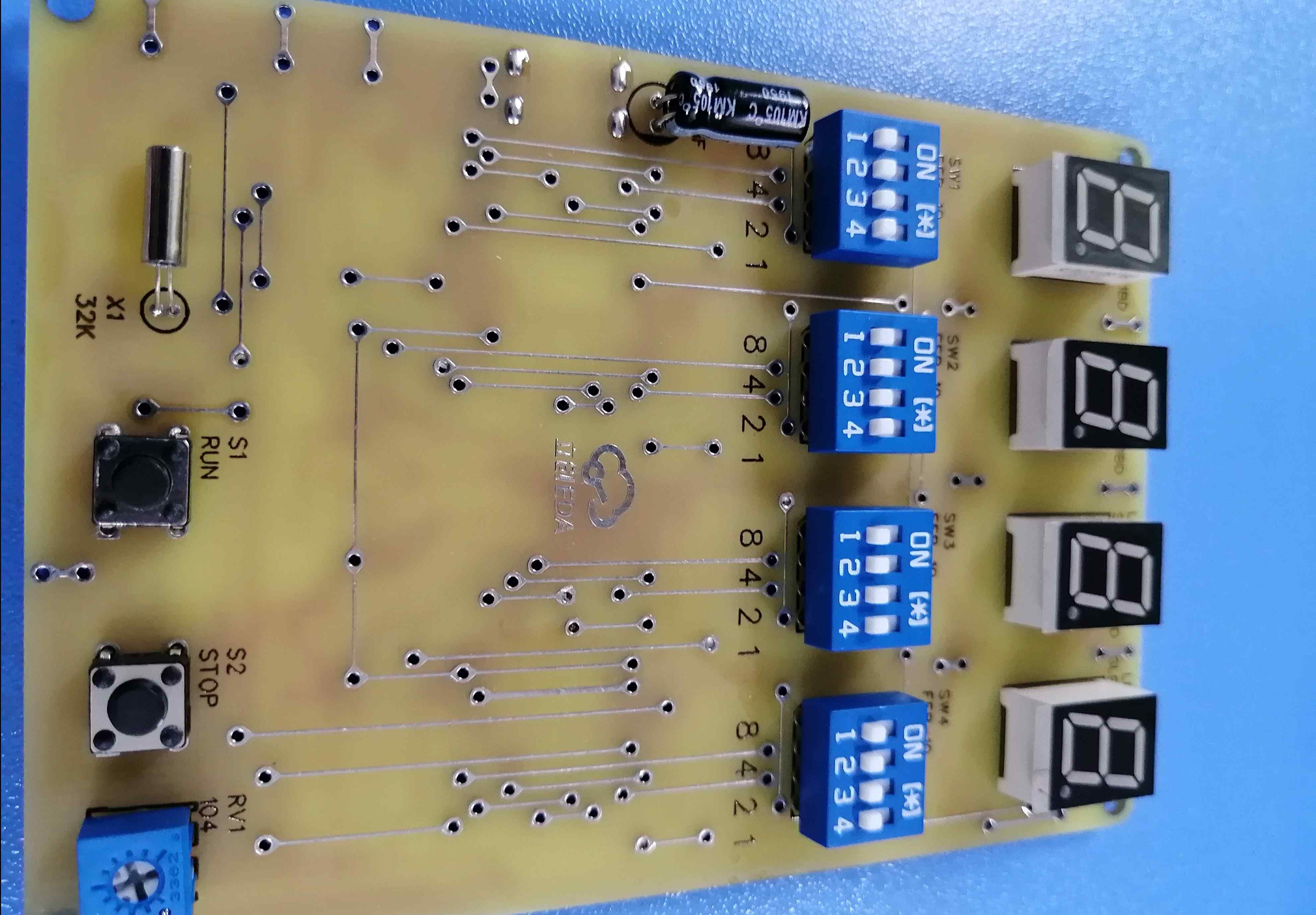

Pure Digital builds a random number generator with range setting
Using 4-digit digital tube,
Paired with CD4511 digital tube decoder.
The counter is a CD4518 decimal BCD counter.
Range setting uses DIP switch as input.
After the CD4077 XNOR gate and then through a series of AND gates, it is sent to the clear 0 end of the clear counter to complete a cycle.
The display range is set to 0~9999. Since it is an asynchronous reset, the actual range that can be used for lottery is 0~9998.
The top layer is not painted so that the bottom layer can be seen through the transparent FR4 front and show off my single-sided PCB technology.
The flying wires all have 30mil openings, and the top jumpers do not turn, making them very suitable for single panels.
The circuit board has a bug, requires flying wires, and is not easy to start vibrating. It needs to be modified.
Appreciation of welding finished products
Appreciation of patches IMG_20200627_113911.jpgIMG_20200627_113905.jpgIMG_20200627_113858.jpgIMG_20200627_113850.jpg
Finished product
Because the circuit board has bugs, one of the videos below is a single panel made in school. The back is not shown. It is so rusty that it turns black.
