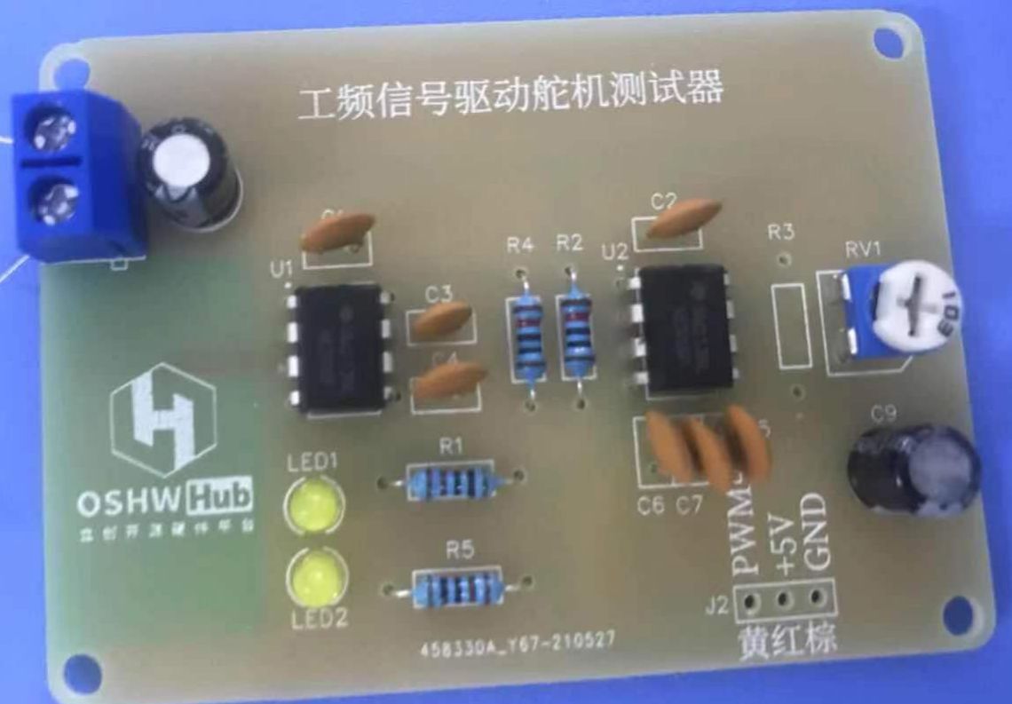

I don’t need to elaborate on what it is used for and how to use it. Taobao has a lot of similar products.
Function: Output 50Hz pulse, pulse width adjustable from 0.5ms to 2.5ms.
working principle
Shape the 50Hz signal obtained from the antenna into a square wave. If it works properly, you can see LED1 and LED2 glowing at the same time.
R2, R4, and C3 form a differential circuit. U2 forms a monostable trigger, and the adjustment range of the trigger is also calculated, solving 0.5ms to 2.5ms.
Formula: f=1/(2ΠRC), T=0.693RC.
Debugging results
Note that the antenna is not sensitive enough. You may need to place your hand on the antenna to get a signal.
