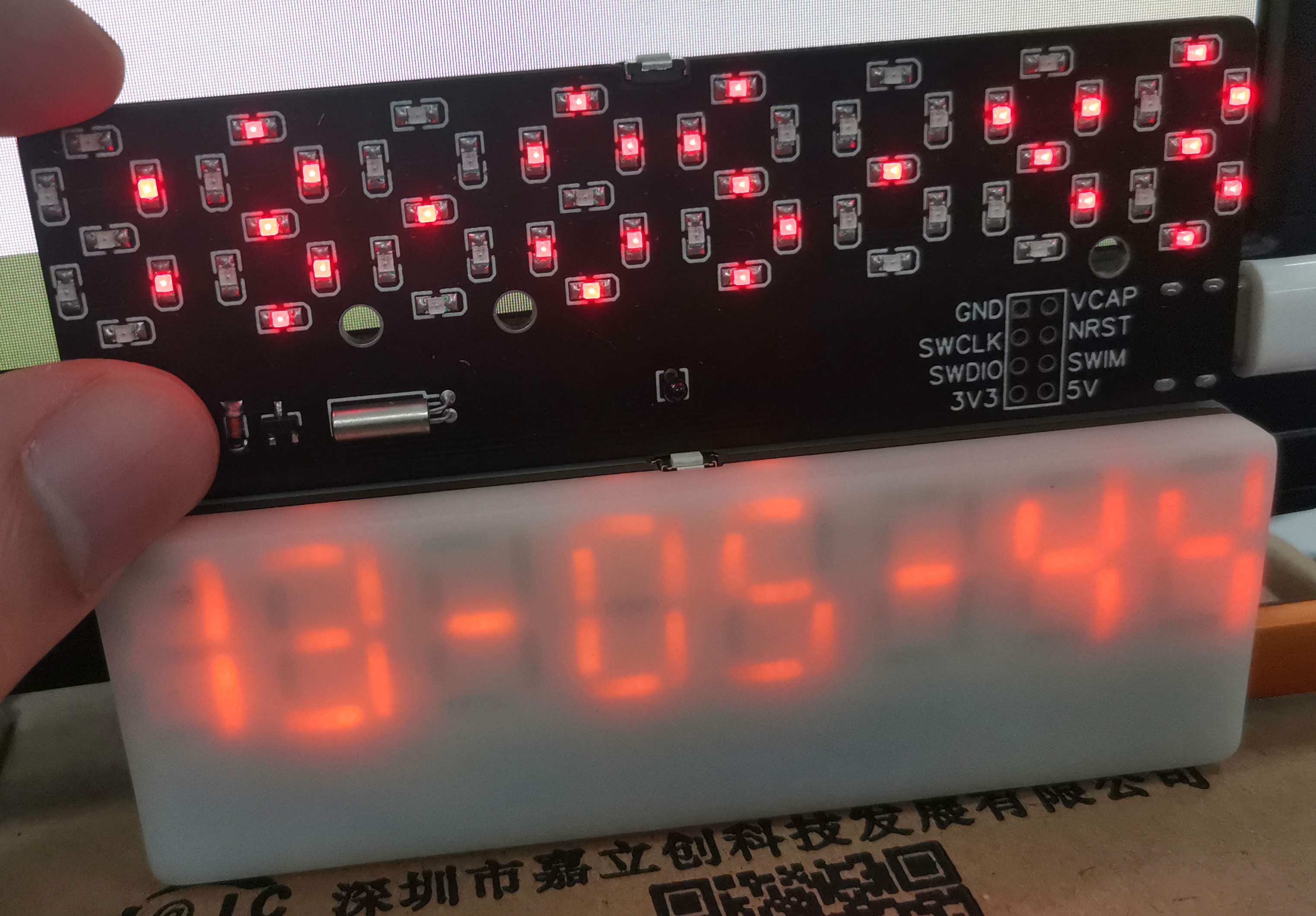

Using Charlie multiplexing method to drive digital tube, the most elegant bar clock
Preface
Digital tube drive circuit: Charlie multiplexing method
8 IOs drive an 8-bit 7-segment digital tube, and the circuit is very similar to the key-conflict-free circuit of most mechanical keyboards . So the names are consistent.
The digital tube is integrated on the PCB, and the light transmission is softened through 3D printing parts, and the integrated display of the shell is more beautiful.
In the later stage, we tried to transplant the program of foot-to-foot compatible chip. At present, we first developed the sponsor of this event: Hangshun HK32F030M.
Let’s complain about the location of the programming port and the multiplexing of hardware I2C. You cannot use I2C while debugging.
Circuit principle description
This is the schematic diagram of using 3 ios to drive 6 LEDs using Charlie multiplexing method.
Assume that P1 is high, P3 is low, and P2 is high resistance. LED6 is on at this time. Although LED1 and LED3 have forward voltage in series, due to the clamping of LED6, the voltage is not enough to turn on at the same time.
If P1 is high, P2 and P3 are both low, then both LED1 and LED6 are on, but the brightness is not as bright as the above state, because the current of both LEDs flows through the P3 resistor, and the voltage division of the P3 resistor increases.
Therefore, a diode is connected in parallel to each current-limiting resistor, and the one-way conductivity is used to make the voltage division at both ends of the resistor consistent in a specific current direction, so that the LEDs that light up at the same time have the same brightness.
