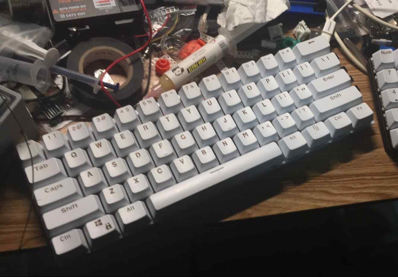

The most beggar 61+3 key mechanical keyboard (appearance)
Program explanation
Let’s take a look at their explanation first:
https://www.bilibili.com/read/cv7465854/
That's right. You just need to know that after upgrading this code, my project will be similar to or even better than the keyboard mentioned in it in some aspects.
Anti-shake button
According to my understanding, the old code is already the first character first, ("&" logical filtering)
Pictured below:
"&", "|" logical filtering
The red line is the recognition situation after "&" logic filtering.
The specific implementation idea is to perform an AND operation on the current data and the data within the previous 10ms, and zero out if there is any, so that the front edge can be recognized as pressed from the beginning of jitter.
The delay is not recognized as released until 10ms after the end of the jitter.
The blue line is the recognition situation after "|" logical filtering.
In the same way, it's just the opposite. Press the delayed action and release it to start the immediate action from the first jitter.
Can we combine the strengths of both? In fact, it's not difficult. As for whether it can be perceived by writing it, I don't know. Discussions are welcome.
Moreover, the 1000Hz return rate also has certain requirements on computer configuration. Someone reported earlier that the computer cannot be driven, so I will continue to use 500Hz here.
The green line is the goal to be achieved, the code is posted below

The code provided below uses this fast and aggressive algorithm that is easy to double-click. If a double-click occurs, it is recommended to revert to the normal version of the code.

Jialichuang's silk screen printing is always defective
Weld the copper nuts, 8 in total (they are a little oxidized and turned red after welding)
Install the keyboard
Positioning plate (this is black oil spray tin, the effect is okay)
PCB photo
Front (the picture with the bottom plate will be added later, the screws are on the way)
side close-up
Open source platform logo close-up
