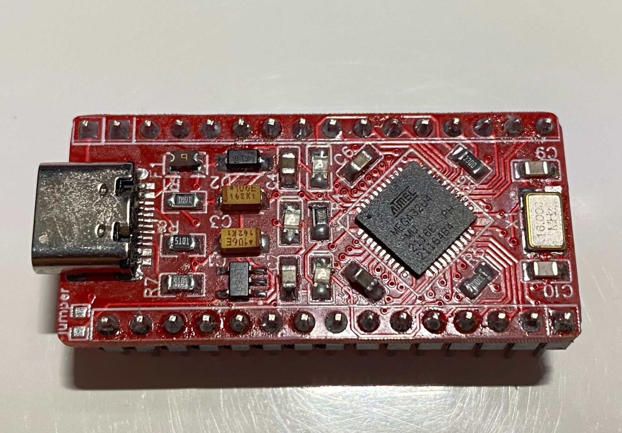

Atmega32u4 core board, TypeC interface, 23 GPIOs
Homemade Atmega32u4 core board.
The core functions are consistent with ProMicro or Arduino Leonardo, and have more IO and greater output power.
This project is a standard version, using QFN-44 packaging, with a total of 23 GPIO interfaces , 1 VCC interface, 1 VBUS interface, 2 GND interfaces, 1 Reset interface, 1 Data+ interface, 1 Data- interface, 1 RAW power receiving interface.
Jumper is used as a jumper and can be connected to a 0Ω resistor or short-circuited. At this time, the chip and peripheral circuits are directly powered by VBUS .
B1, B2, and B3 are CLK, MOSI, and MISO interfaces in order, used for ISP programming.
You need to burn Arduino BootLoader to ATmega32u4 before use. See the video for details: https://www.bilibili.com/video/BV1sQ4y1a7Mj
