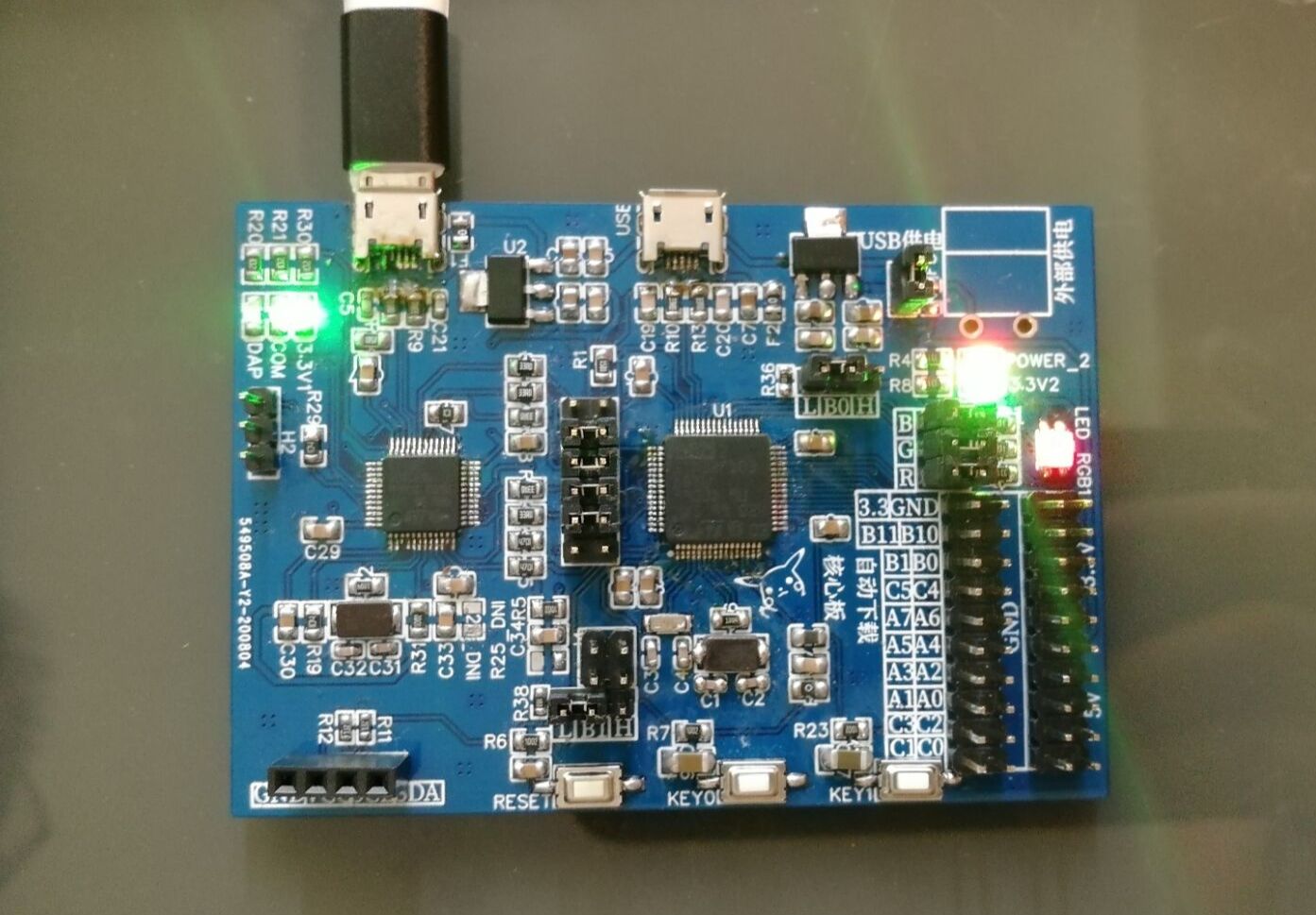

This design is an STM32 minimum system board based on STM32F103RBT6 as the core. I recently participated in the summer school training camp of Lichuang EDA. I want to use Lichuang EDA to draw an STM32 minimum system board. In the past, when learning STM32, I always had to connect an external emulator, which was quite troublesome, so I was wondering if I could use the debugging function. Integrated directly into the minimal system board, so this works.
2. Function description
最小系统板部分:Paired with three-color RGB lights and touch switches, the simplest code debugging can be performed. At the same time, two rows of IO ports are introduced, allowing the core board to achieve more functions. Next to the core board are two rows of power interfaces to facilitate joint development and debugging of external modules.
本设计最大的特点:A debugging module circuit based on STM32F103C8T6 is integrated and designed next to the core board. When this minimum system board is connected to the computer through the USB interface, a virtual DAPLINK disk will be generated on the computer. This can be used as both an emulator and a downloader. As long as you drag the compiled hex file into the automatically generated disk, it can be automatically downloaded to STM32. At the same time, it also retains the function of serial communication, truly achieving one interface for multiple purposes.

The power supply of the entire system is divided into two parts, namely the power supply circuit of the debugging part and the power supply circuit of the main control part. Two separate power supplies facilitate the reduction of power supply noise interference and load pressure. Among them, for the external power supply, I chose to use USB power supply normally, and reserved a line interface so that the 5V voltage of any port can be shared between the two power supplies. For the main control part, an external power supply port is reserved to facilitate the use of external power supply to power the core board independently. TIM screenshot 20200813102952.pngFor the 5V to 3.3V conversion part, I chose the common AMS1117 chip and left a path for LED lights to conveniently indicate the system power supply.TIM screenshot 20200813103202.png
2. Peripheral part
To facilitate user debugging, I added a three-color RGB light to the circuit. Users can use the RGB light to confirm whether the system is in normal working condition. The method of use is also very simple. Just connect the jumper cap. That's it. If you don't connect the jumper cap, it will be used directly as an ordinary port. TIM screenshot 20200813103509.pngIn addition, I have also reserved two external buttons to lead to the OLED connection port and two ports to make it more convenient for users to use and debug in general.
3. Main control board and debugging board part
Regarding the main control board and the debugging board, I tried to separate them as clearly as possible during the circuit design process, and connected them using jumper caps and pin headers. When we want to use its debugging function, we You can connect all the corresponding jumper caps together, and you can directly download the program for debugging. After removing the jumper cap, we can also directly connect the debugging part to other microcontrollers through jumpers, which is more convenient. to use. In fact, I designed it this way to facilitate people who are interested in re-dividing the debugging circuit and using it as a separate module.TIM screenshot 20200813104222.png
5. Layout settings
Looking at the whole, the overall layout is divided into the debugging circuit part on the left and the main control part on the right. In order to facilitate debugging, the pins of the system are distributed around the board as much as possible, with a jumper port for debugging communication between the two boards in the middle. At the same time, in order to make the STM32 main control part work in different working modes, I reserved the boot pin for easy adjustment during use. Through learning at the summer training camp, there is no copper laid under the crystal oscillator, and the power input must pass through filter capacitors, etc.

August 10th: The components, boards, etc. arrived, and we started welding. During welding, we noticed that the Micro B interface of the UF-M5DD-Y-1 model was not very easy to weld, so we need to pay attention to it.
August 12: jlink arrived, software debugging was carried out, and the debugging was successful.
7. Physical display
TIM picture 20200813134942.jpgTIM picture 20200813134937.jpgTIM picture 20200813134930.jpg
