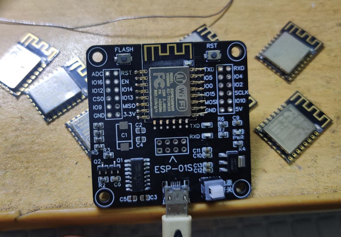

Can be used for testing and programming esp-12f/esp-12e/esp-01/esp-01s. Remove the plastic from the ring, break it open a little, insert the long one toward the middle, cut off the short end that is too long and weld it, use needle-nose pliers to break off the top of the long side to the outside.
Modify from the open source project , fixed the bug that could not be uploaded automatically, and replaced the interface and buttons
