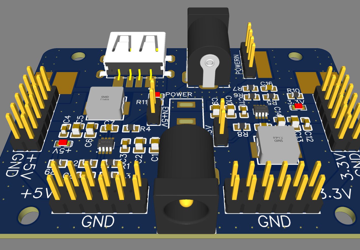

PCB layout
We can refer to the layout reference diagram given in the data sheet: image.pngthe key points are as follows: 1. The inductor should be as close to the chip as possible, and the length of the LX line should be minimized. 2. Do not route wires under the inductor, especially high-frequency signal lines. Keep the wires as far away from the inductor area as possible, if necessary. You can hollow out the copper area for this part to reduce unnecessary energy loss: image.png3. The capacitors at the input and output ends should be as close to the chip as possible:image.png
