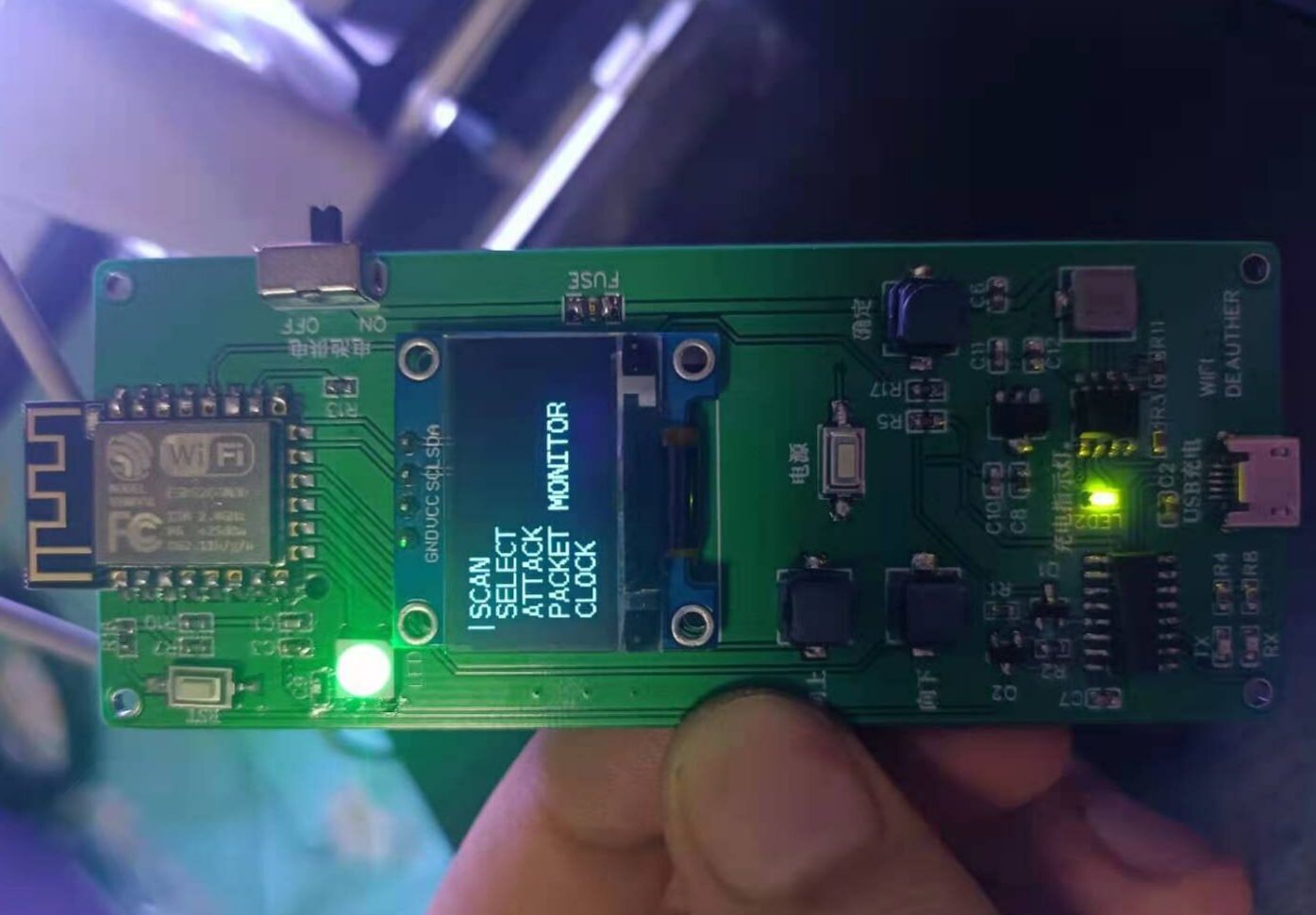

The project source code is in the attachment. If you want to change the pins, please open the A_config.h file and modify it yourself. This project has been modified according to the schematic diagram, and you can compile it directly.
First download the Arduino IDE, select the 8266 development board, open esp8266_deauther.ino and upload it.
The data folder in the project is a web page file on the web page. Use the option in the picture below to upload it. The built-in development environment does not have this option. Specifically, Baidu
How to upload files to 8266 spiffs.
Restarting is OK.
Attached are the before and after photos:
