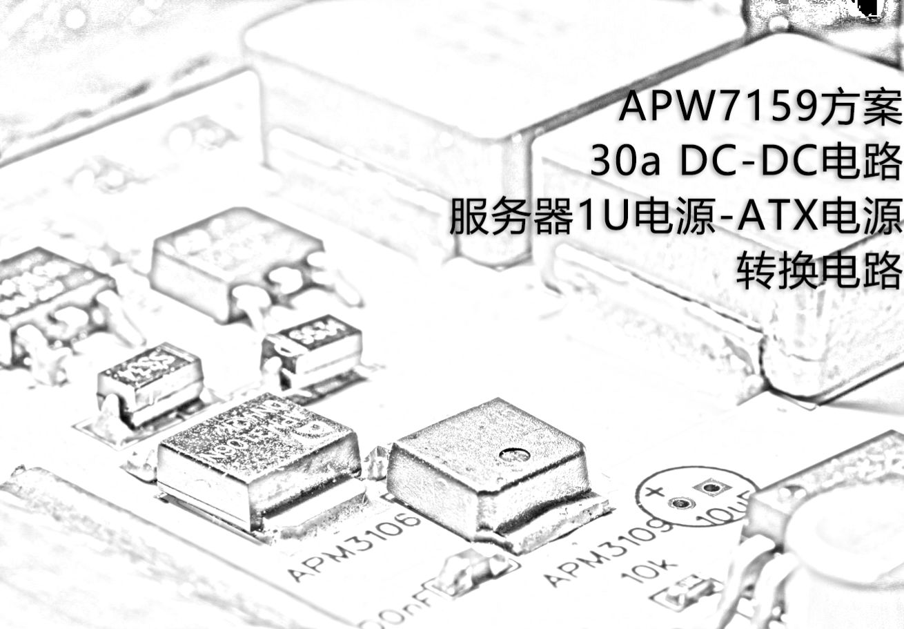

This is the 2 8pin and 6 hard drive 5pin version. It can be soldered only
for players with many hard drives.
Note that it is best to solder the lower pin on all sides. That is, after plugging it into the dcdc board, there will be solder on the bottom and top, like an xy coordinate. Axis, four quadrants, all four sides are filled with solder
In addition, the plug-in direction is outward. If you plug those wires inward, it will short-circuit.
